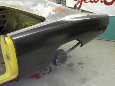

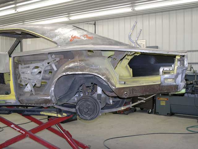

I believe Mopar Muscle did an article that is still available online where the use a (to my knowledge) somewhat non-standard approach be overlaying the new quarter on the old and cutting both with a wheel that is the same size as a MIG bead, then tacking every 18 inches in "circles" until it's filled.
Everyone I've showed that article to says "that's wrong"..."you need to use a tool that creases the panel and allows you to overlap one panel on the other".
I think the article is better because it doesn't stress the metal and leaves no seam at all if the welds are ground properly. It also leaves as as many of the structual parts of the old quarter in plase as possible, if they are good.
http://www.moparmusclemagazine.com/techarticles/body/mopp_0506_panel_rust_removal/index.html
http://www.moparmusclemagazine.com/techarticles/body/mopp_0507_panel_rust_removal_2/index.html
