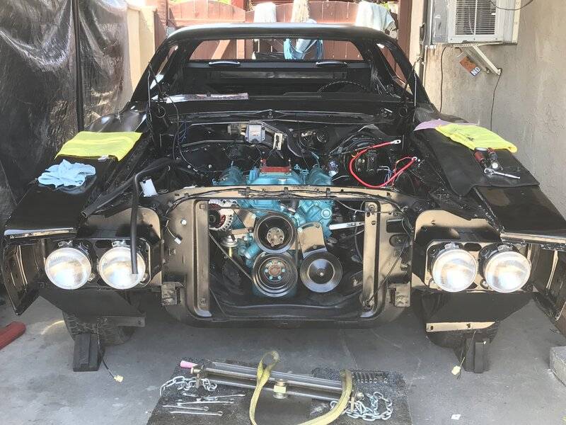

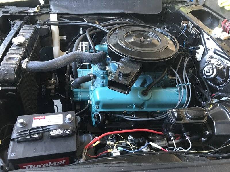

Lets see some pictures of the Charger.
:xscuseless:
574A165B-32C1-45C7-AC89-02DAD95397DA.jpeg A3BBDC61-2A53-4413-B8F4-1C5E77FBA3A5.jpeg
