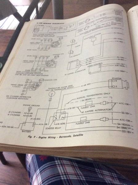

I got a new under hood harness for the 69 Bee. It has a pig tail that says fuseable link. Does this go to the battery? I guessI have to add my own fuse to the harness.
I got a new under hood harness for the 69 Bee. It has a pig tail that says fuseable link. Does this go to the battery? I guesd I have to add my own fuse to the harness.
My wiring diagram says it is a dark blue wire and the ring terminal goes to the stud on the starter relay, the same post the battery lead goes to. As it's name implies, it is the fuse, no extra required.
Tim

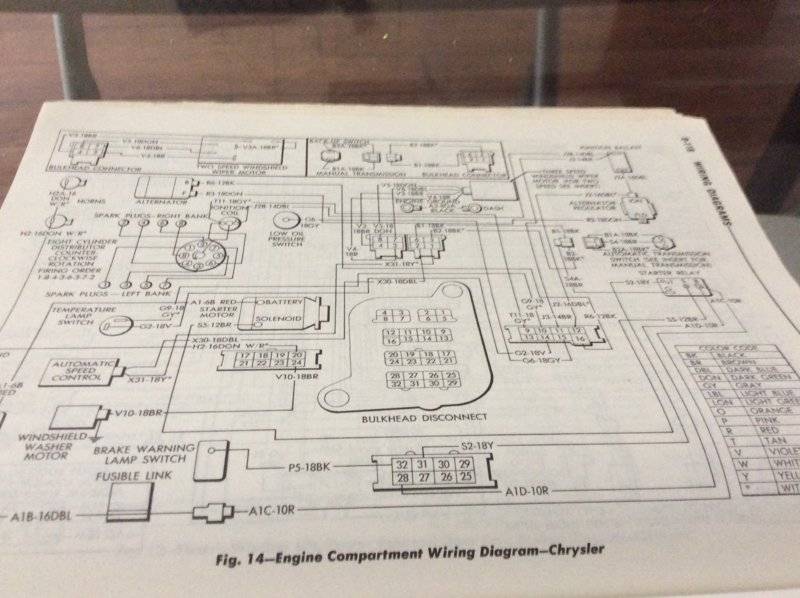

It goes to the lug on starter relay along with the other battery cable the smaller one of the two. The fuseable link is coming off the alternator. That’s how my 71 rr is setup up
Here are some wiring diagrams from a 69 Chrysler manual and a 71 Plymouth Manual. Hope this helps.
