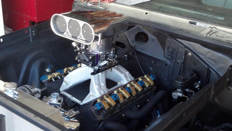

my latest cranes came with springs and thin washers to take up any slack.mounts are mopar perf. 2012-06-06_15-03-53_673.jpg
