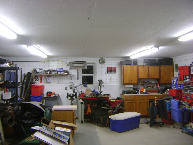

I have a Lennox natural gas overhead space heater in my 2 car garage. Works on a thermostat. I turn the heat down when not working and turn it back up when I am in the garage. Works great. Blows warm air the entire length of the garage. You can see it on the back wall over the tool box in the photo.
Get a Lennox LF24-30 (30,000 btu,s) they cost about 700 bucks. It will heat your garage just fine. They hang just 1" from your ceiling, and are 13" high for a total of 14".

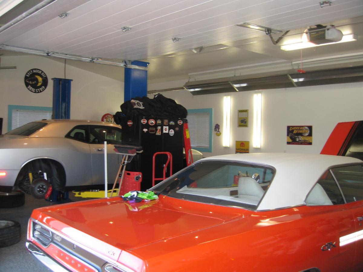

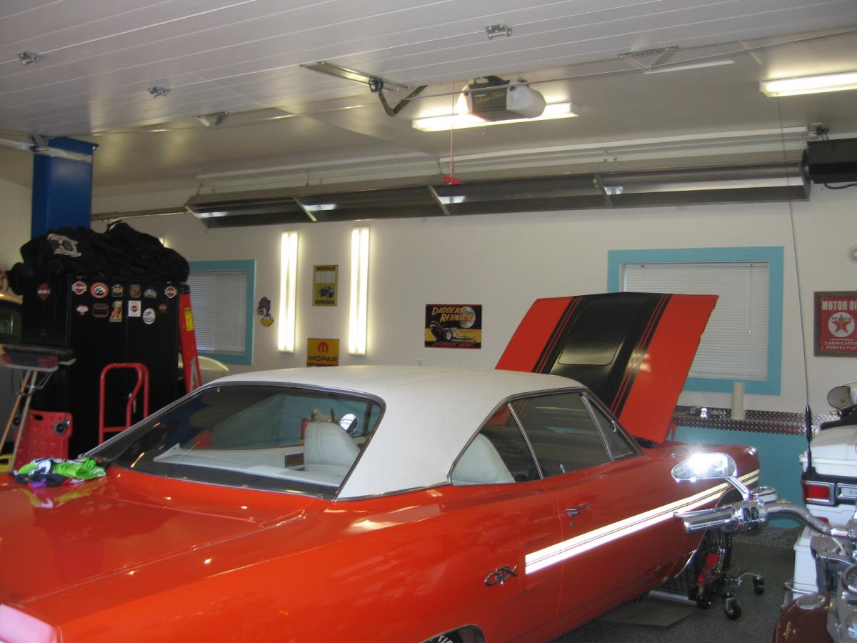

Mine's a 36 X 22 with R 20 in the walls and R 40 in the cieling. I installed a radiant tube for heat as they are reasonoable in price and are efficient and easy to install. I have a standard 10' ceiling in half of the garage and a vaulted ceiling (12' 1 1/2") in the other half so I mounted the tube along the front wall of the garage at a 35-40 degree angle.

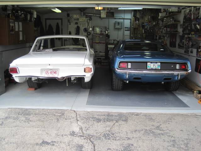

What size is your door?

EV2, That is one nice looking garage! I've got a standard 2 car w/ a single door 16' x 7' & no windows . Going to go w/ the rigid pink foam insulation on the door I believe and cover in the white vinyl sheeting so it doesn't look like a sorority house when I shut the door.

Thanks Coledavis, I just built it this year and it was a long summer.
