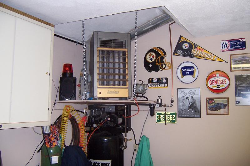

Hello. I have a natural gas unit I picked up used for $50. Its a 80,000 btu ( not much breaks on these units, Gas valve is the most expensive thing ). Heats my 24' by 24' garage in 10 minutes. Electric is expensive up north here. Of course my garage is fully insulated ( loft and all )

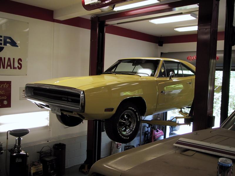

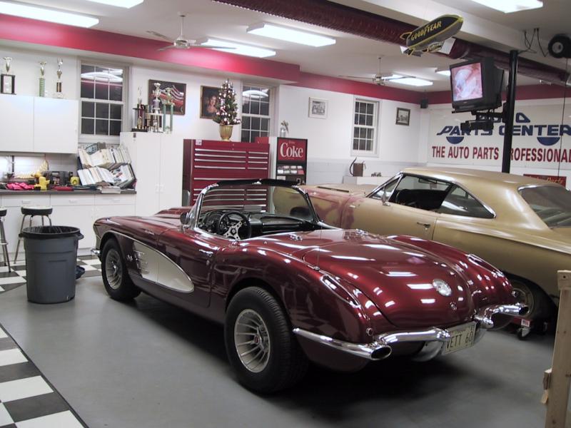

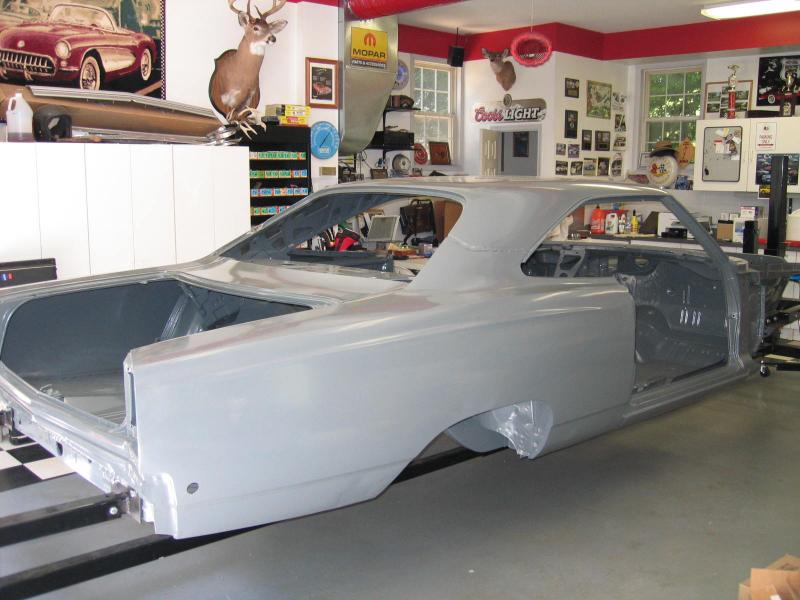

When I designed my new shop 35X45 I used a three ton heat pump with LPG gas back up. I turn the heat down to 55 when Im not in there. But when I go out and turn it up It heats up pretty quick with gas, then the heat pump keeps it up to temp. Have 6 in walls with R19 and R30 in the ceiling. Also I installed Overhead roll up doors insulated with R6.9 foam inside. Makes a huge difference. My house actually uses more electricity than the shop does. I ran one duct overhead with vents , and also have ceiling fans to foce heat down. Shop has 10 ft cielings with one 15ft wide bay At 14ft cielings for lift.
