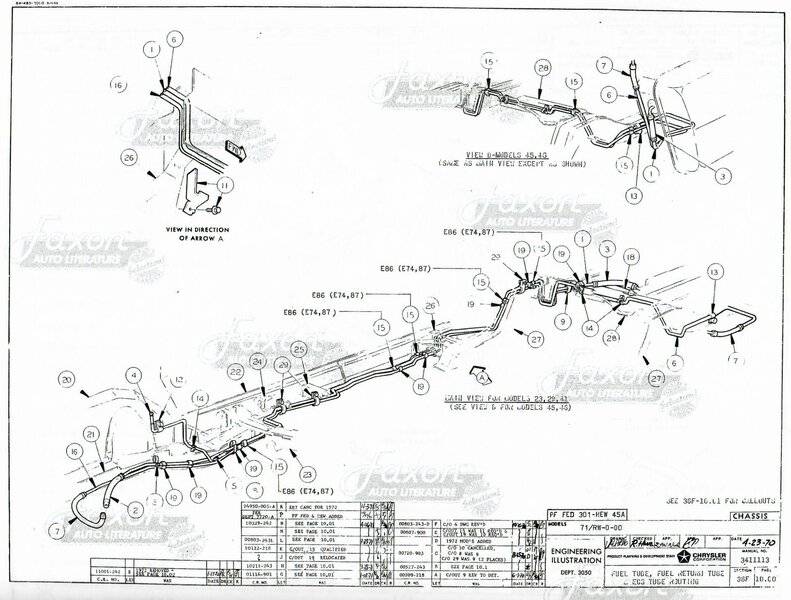

Would that have been run on Passenger side frame rail also or a different location ?As stated, if the car was equipped with a fuel pump mounted vapor separator, a ’71 440 should have been, the 1/4” return fitting would have been plumped back to the sending unit via a third ¼” line. The 5/16” line from the fuel tank vapor separator/expansion tank needs to go to the 3-nipple breather, this effectively is the fuel tank vent.
1/4” fuel sender vapor line to fuel pump
