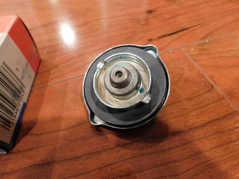

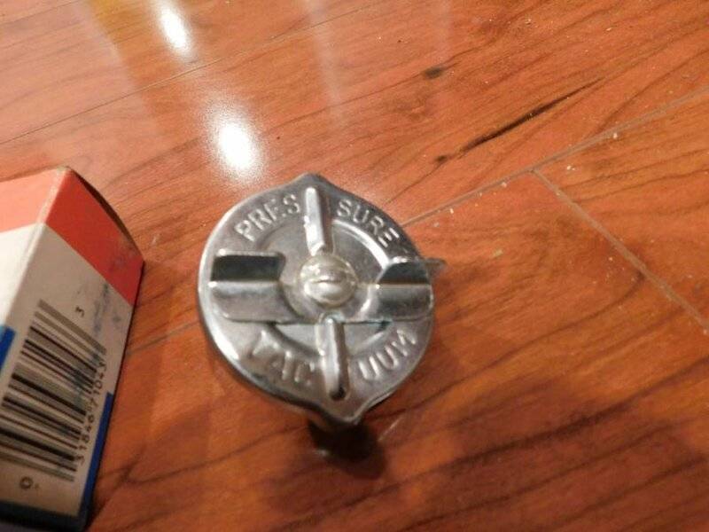

Does your cap look like this ? 1971
You can see the tiny hole inside the white plastic , spring operated pressure release
The factory gas cap was pressure vacuum or so called
The pressure vacuum gas cap is designed to vent small amounts of air into the car gas tank . The vented gas cap has a one-way release valve that is pressure-activated. When the pressure reaches a certain point (defined by so many pounds per square inch) the valve opens by a very small amount, relieving some of the pressure by allowing air into the gas tank , not out into the atmosphere

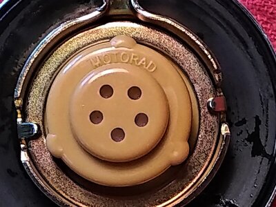

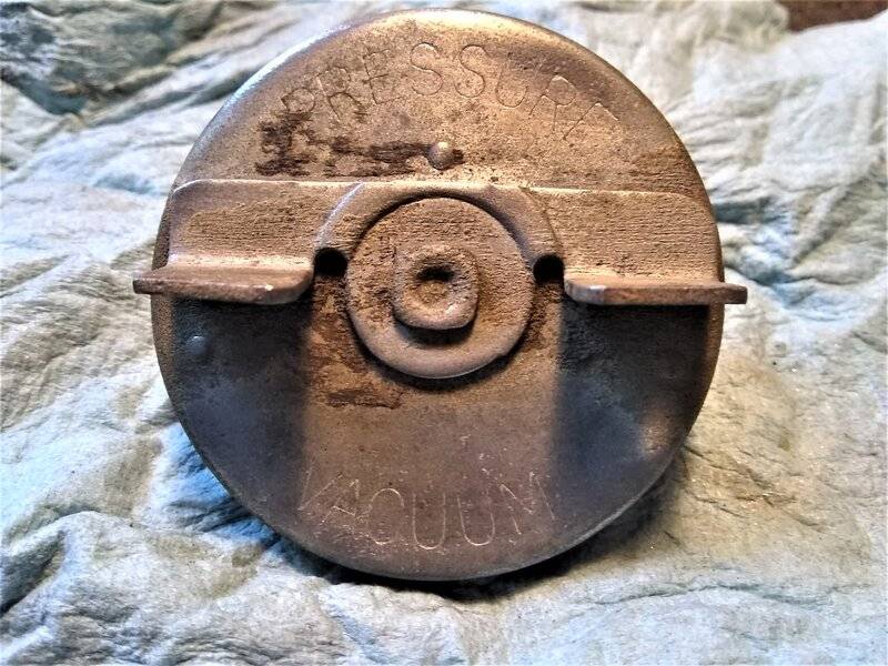

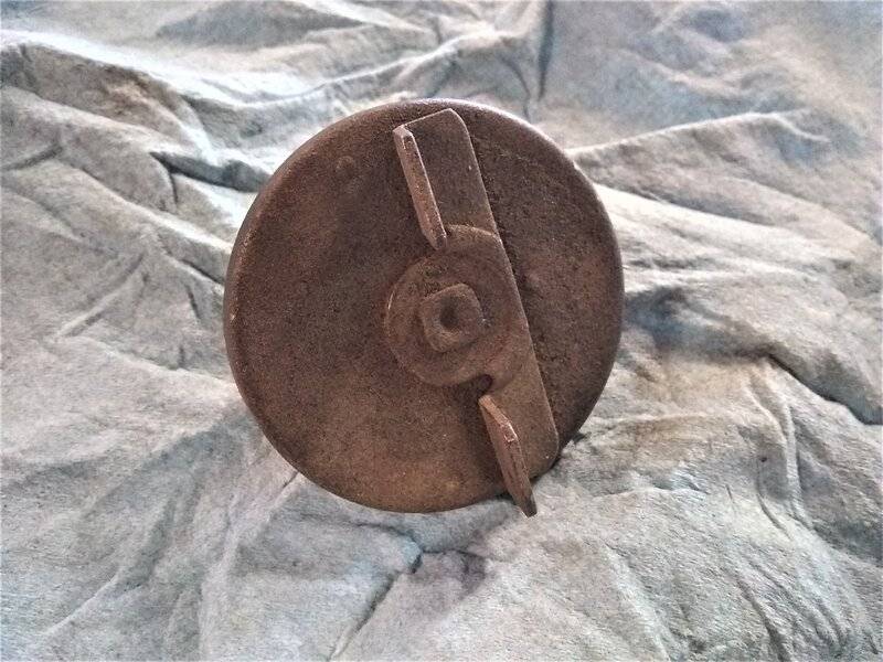

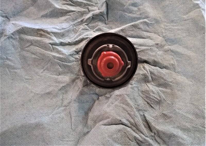

I replaced the rubber vent lines and Gas Tank a few years back.Today I cleaned the cap and it reads "Pressure Vacuum" So maybe this is a Normal thing.I think my cap is original so i might replace it anyway.So it is "Non Vented". I don't hear a "rattle" when i shake the cap ,like some do.
I believe the red plastic thing is a vent?
Yes , like in my description that i posted earlier
Keep that - It looks original
And see the pressed in rivet on the front side
The raised area or the lip around the washer for rivet , you see two small holes like a C inbetween the turn flange
Is your two holes that allows AIR TO ENTER through the gas cap into the gas tank , not vent into the atmosphere like you would think
Complete opposite

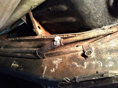

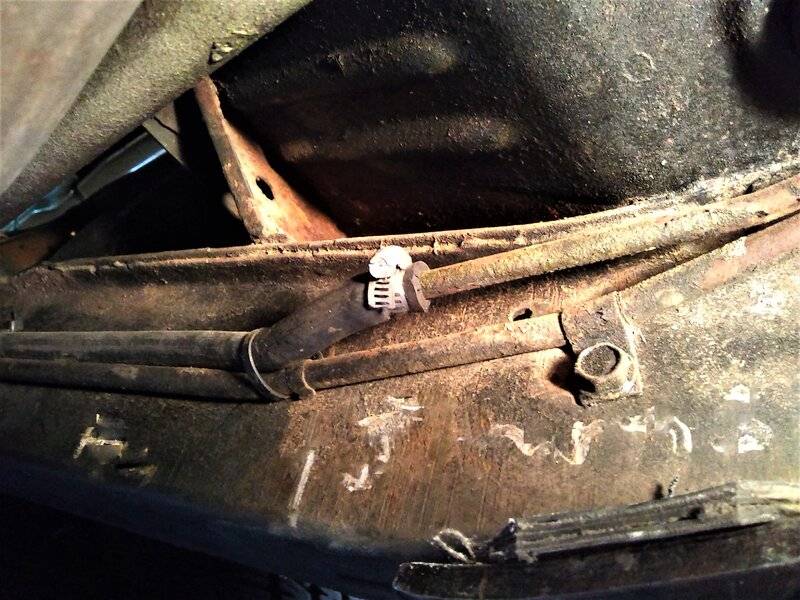

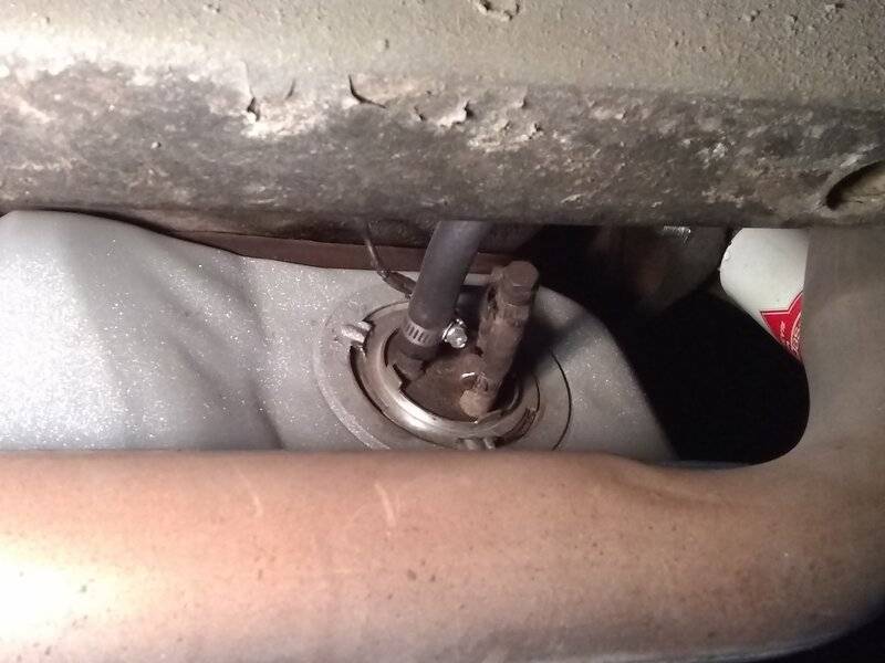

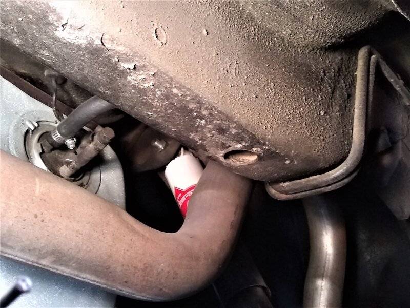

Well here are some pics.Return line on sender Plugged.Two lines going to front of car,(3/8" line to Fuel pump).
The other line 5/16 goes to the return nipple on the Vapor separator/filter mounted at fuel pump.The Metal 5/16 line ends at firewall below r.f fender.Probably supposed to go to the 3 Nipple Breather cap.Should i have 3 lines running on the frame rail ? Only see 2 lines.

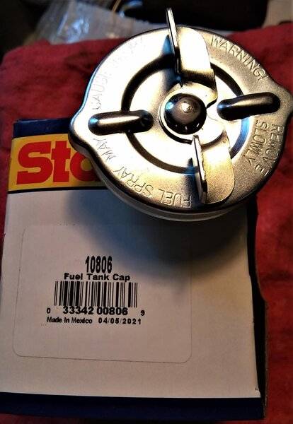

Okay I started with a STANT 10806 from Orielly and that did not fit. Tried a 10807 STANT and it fits REALLY SNUG, but it fits. The vent lets air in and not out (tested with a mitivac and some heatshrink tube).

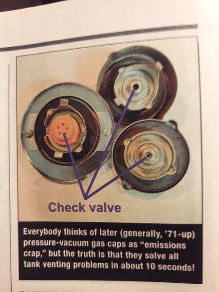

Like I said in this month's Mopar Action Rick Ehrenburg recommends at vented gas cap for ALL cars (old MOPARS) regardless of emissions, or not.
For $6.99 it's a good experiment and my present gas cap has seen better days anyhow.

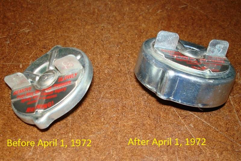

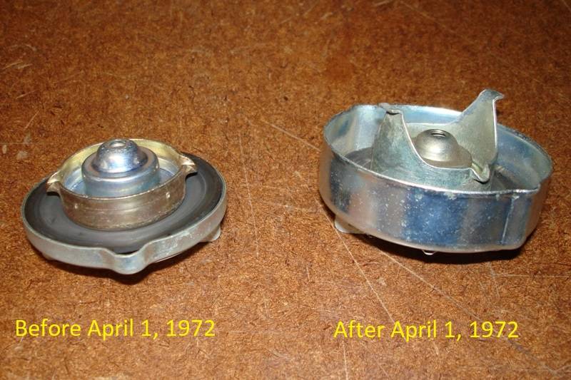

Yes, that is normal for that car on warm days. The correct single action cap for ’71 has an over-under pressure relieve valves, it is not a vented, should not be a vented cap. The ’72 mid- year production change to double action caps and filler necks was April 1, 1972. I’ve had no issues with Stant caps when used on the correct application.
Here is the mopar action response in the tech article about gas caps.
As stated, if the car was equipped with a fuel pump mounted vapor separator, a ’71 440 should have been, the 1/4” return fitting would have been plumped back to the sending unit via a third ¼” line. The 5/16” line from the fuel tank vapor separator/expansion tank needs to go to the 3-nipple breather, this effectively is the fuel tank vent.

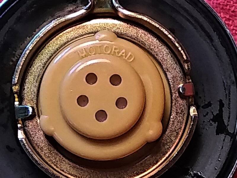

Got a new cap Stant, says Motorad on cap.Got swoosh and back of cap had gas on it(only 1/2 tank).Cap fits snug probably because of new rubber seal.So i need to get a 1/4'' return line.I am still wondering why i see no indication of the original return line.The other two lines are original.
