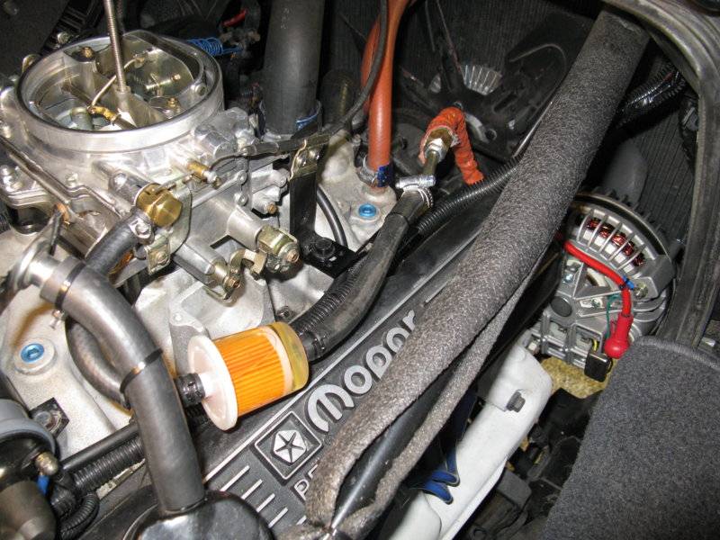

Same Problem on my 73 B-100 Van with Edelbrock 1405 carb. After pulling the van into the garage on a hot (80+ deg) day the fuel would boil and the garage smelled like I pored gas all over the floor. After installing a 1" Phenolic plastic spacer (Edelbrock 8711) the gas smell problem went away although if I don't start the Van for a few weeks I still have to crank it for a while to to get fuel to the carb. Because my application is a Van I also had to install a drop air cleaner pan and modify some linkage to get my clearance back for the engine cover to fit.
Just recently installed a 2nd fuel filter at the Carb (stock filter is under van), I sloped the feul line to prevent fuel from running back toward the stock pump so the filter remains full after shutting down, I am hoping this small amount of fuel will reduce the amount of cranking I need to do after the van sets for a few weeks. Will not be able to test this theory until this winter. If you look hard you can see the spacer in the photo...
The see through filters are great but I recommend a metal filter. (especially on a van)
