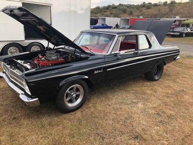

I need help. My father built this Hemi Belvedere and unfortunately, passed away last year. I'm in the process of fixing a few loose ends. I cannot get this gas gauge to work. I've checked grounds, wiring, etc. I believe the dash has a voltage regulator in the back but I don't know how to test. Any help is appreciated.
sorry for your loss, nice car, get a friend to help, with the key turned on, slide under the car and pull off sender wire, have a piece of wire with you , have friend watch gauge while you take wire an ground the sender wire to the frame or good ground, the gauge should go up. don't ground it very long. if it goes up you know the wiring and dash are ok. the problem is the sender or gas logged float.

That car is sweet.:thumbsup:
