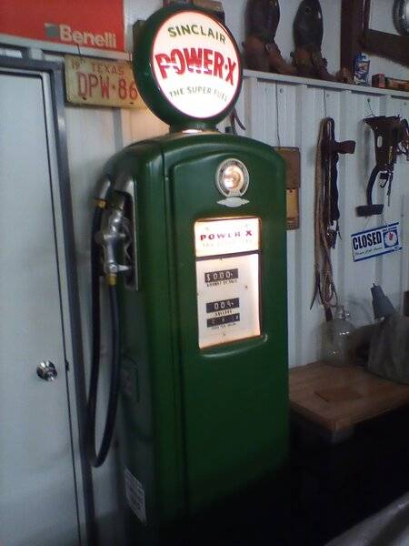

This one is completely original. Had to replace one of the round glass Power-X. Thanks to gaspumpheaven. Still has price of 26.9 gallon.

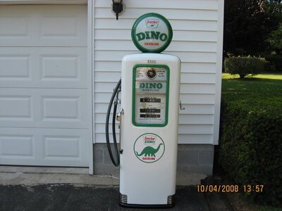

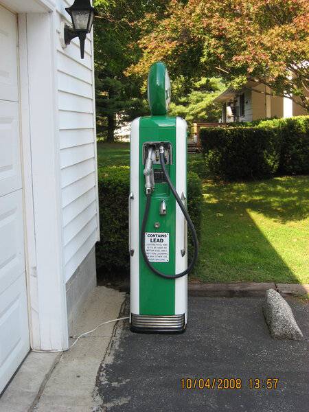

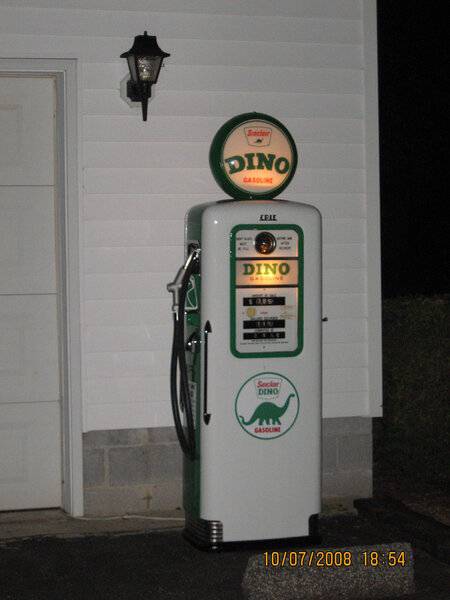

Just like some car models, certain gas pump brand stuff is available in reproduction while other brands are not. I took an old generic Erie pump and made it into a Sinclair gas pump. The top globe is reproduced in plastic now while the originals were all glass. The decals are available via several places online, and the gas nozzle I got from Tractor Supply. Everything that says 'Dino' or 'Sinclair' was/is available in reproduction. The chrome pieces of the pump were sent out for re-chroming, so make sure your wallet is up to the task at hand. lol
I had a local auto body shop spray the green and white paint, and clear coat it because it sits out in the weather at my workshop. I added a photo cell and 2 led bulbs so the top globe and front panel light up at night from dusk till dawn. It's been a great conversion piece, especially when I have the price per gallon set to .35cents which is the cheapest I can remember my parents paying for gas in the mid to late 60's.
Have fun with it!
Restored Erie Pump 002.jpg Restored Erie Pump 001.jpg Restored Erie Pump 014.jpg

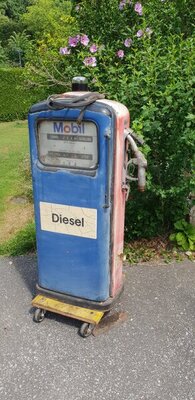

Note: Be aware of the weight. I thought I could move it by myself with a good dolly. Wrong. I still think I'm a youngster!
I did mine 5 years ago and did not have any problem finding anything for it. They are very heavy and taking out the pump and motor helps.
Very true re the weight of these! The pumps in them are all cast iron components, no steel, to prevent any potential explosions while moving the fuel. Remove the internal 'plumbing' as soon as you can to move the pump around a bit easier.

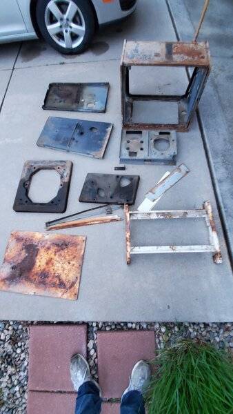

I didnt realize that i started this thread almost a year ago, but i got my pump this summer, and have already stripped it down and am now in the rebuild phase of this project. Its a Tokheim 1150 pump.
Here are some pictures of it getting stripped.

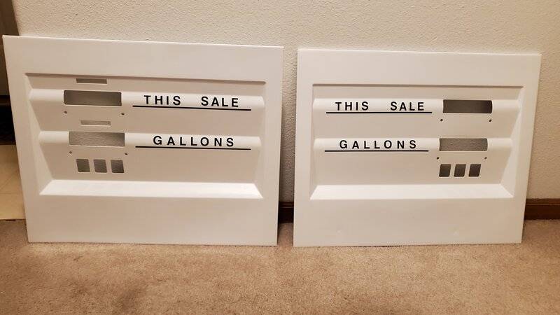

Nearing completion. Got my throwback lettering for the ad glass space, looks cool i think, this is a fantasy pump which most likely had the fuel type up top and nothing on the bottom, but i like the mix of old and new.

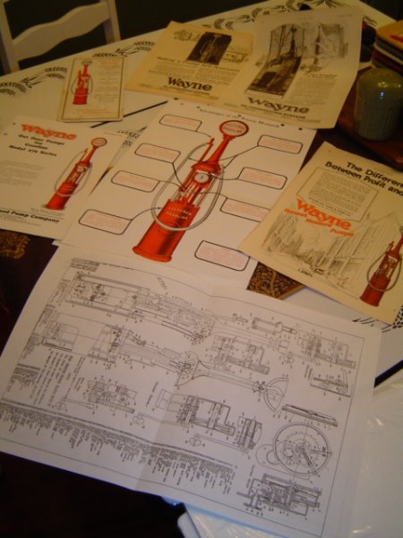

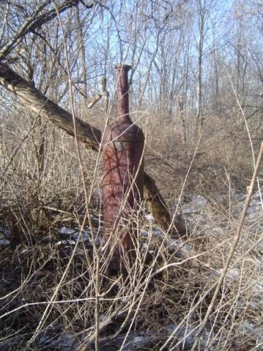

I need to get back on my Wayne 276, from 1916.

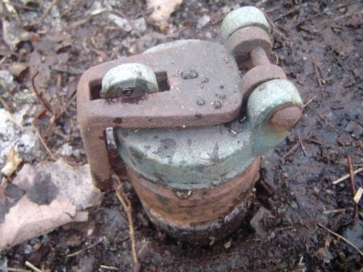

It was on my parents farm growing up, I even took the underground fill neck and all the switches/conduit that was on a makeshift wall next to it.
I have since bought another one, in better shape, for parts, and believe it or not, bought nos, never installed, from 1916, upper and lower skins!
I also found original colored sales materials, installation instructions, parts diagram, and an original globe.
These globes were immediately tossed and a globe with the brand of fuel installed.
This is a monumental endeavor.
