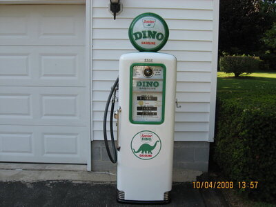

Just like some car models, certain gas pump brand stuff is available in reproduction while other brands are not. I took an old generic Erie pump and made it into a Sinclair gas pump. The top globe is reproduced in plastic now while the originals were all glass. The decals are available via several places online, and the gas nozzle I got from Tractor Supply. Everything that says 'Dino' or 'Sinclair' was/is available in reproduction. The chrome pieces of the pump were sent out for re-chroming, so make sure your wallet is up to the task at hand. lol
I had a local auto body shop spray the green and white paint, and clear coat it because it sits out in the weather at my workshop. I added a photo cell and 2 led bulbs so the top globe and front panel light up at night from dusk till dawn. It's been a great conversion piece, especially when I have the price per gallon set to .35cents which is the cheapest I can remember my parents paying for gas in the mid to late 60's.
Have fun with it!
