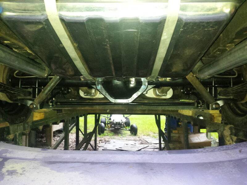

Is anybody putting anything between the gas tank and the straps? If so. What are you guys using?
