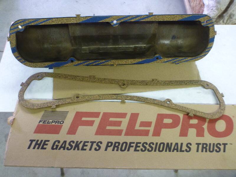

I tried the expensive and fancy route on the Bee and fought them leaking out the back and down the block. Back to basics when I did the 340 in the Dart. Dolly all the mounting areas flat, cheap old cork and zero sealer = ZERO leakage the first shot.
It doesn’t take all the trick products to stop oil leaks. Stick to the basics.

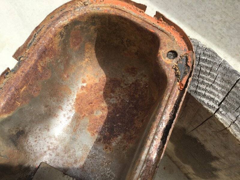

Any recommendations on how to straighten the valve covers? They are stock stamped steel and pretty bent up at the mounting holes. At least I found the problem! Thanks. Mike
A pick hammer on a dolly or flat anvil surface. Indian head on gasket.
Sorry for the dumb question. Is Indian Hess a sealer?

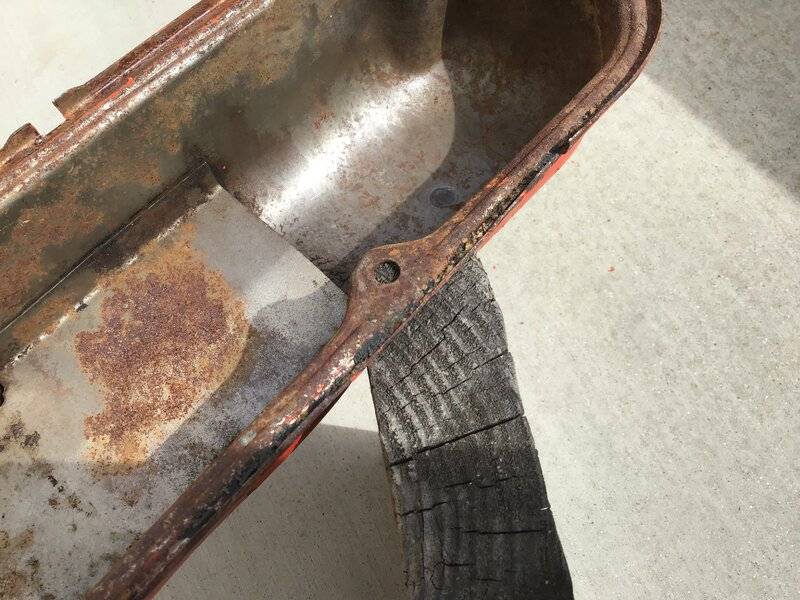

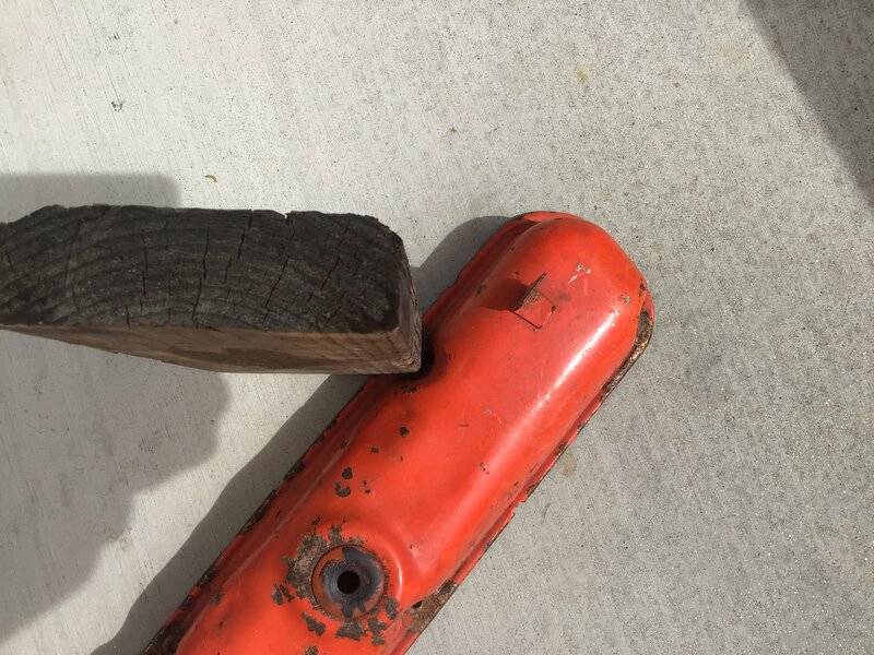

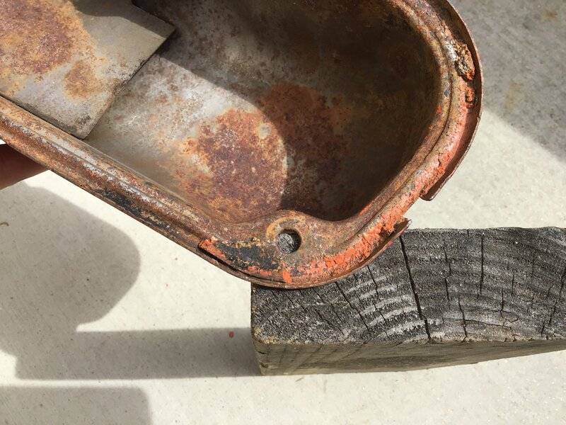

2x4 or 2x6 on the top side supporting the rail. Turn it over and tap with hammer. It will straighten the lip. I use a regular hammer and strike it flat. Practice on one at the junkyard if you need to.
Before installing clean it very well with brake clean. Wipe many times changing to a clean part of the rag. Should be clean on the rag, then you have it clean. Clean the bolts and the bolt holes also.
Don’t overtighen. Let it sit before running and snug them up as gasket compresses. After running it hot and cool down snug up the bolts.
Indian head is a very sticky sealer, it is hard to remove later. That’s why I don’t use any sealer on valve covers.
CBCC57AC-2F7D-4FC2-8E52-245A625D74AA.jpeg CF5ADF0C-E04B-4FA8-9B42-D98FF7D7804C.jpeg 2CE72F01-E568-4C11-A349-97567B34FDA3.jpeg 324C06F6-6FDB-46FA-9971-28FEEE4DAAA8.jpeg
