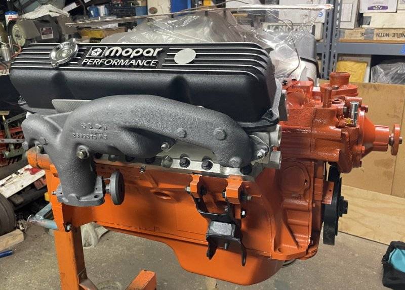

Did a mock up using Mopar cast valve covers and Felpro gaskets MS 90425. I cant remove the passenger valve cover unless I loosen the manifold. The extended gasket makes it too close to the valve cover. Any ideas?
I had to grind the outer lip a bit between the 2 and 4 plug for it to work. Same valve covers and gaskets.

Try the valve cover with bolts instead of studs, see if the cover will come on and off without the studs in the way.
Like Daliant says it’ll probably come off if you use bolts instead of studs, I’d just grind the valve cover where it hits and touch it up with black and none to the wiser. It probably won’t take much.
Trim gasket to fit the manifold. Hold the cover up as far as it will go against the studs before tightening down.

Remflex exhaust manifold gaskets on my 383 give plenty of clearance with those valve covers.

I have those valve covers on my Charger R/T with stock HP manifolds on stock heads and they can be removed with no interference from the manifolds. The aftermarket heads are probably what is causing the issues. Trim the gasket back until it is flush with the edge of the valve cover. Dubb,HP manifolds don't make a car look less like a muscle car. Putting 383 two barrel log type manifolds on an HP engine to make it appear more stock and perform less is the equalivent of putting dog dish hubcaps on a muscle car!
Outside the box, maybe a removable heat shield?
