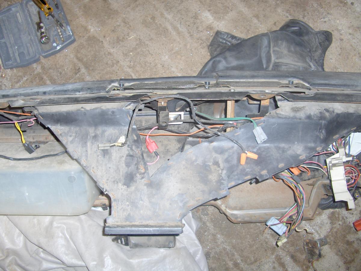

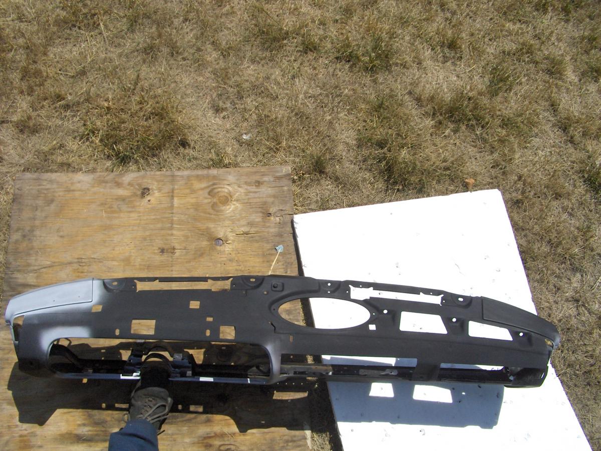

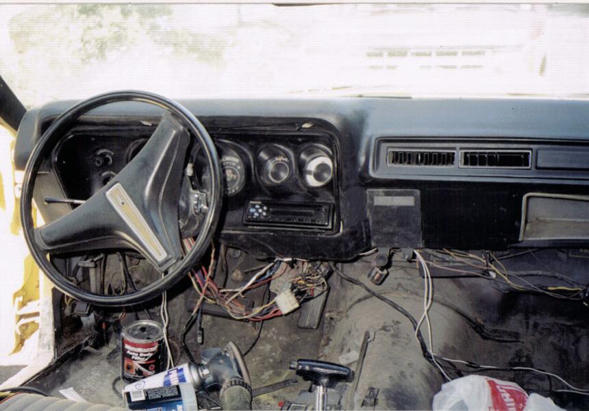

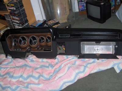

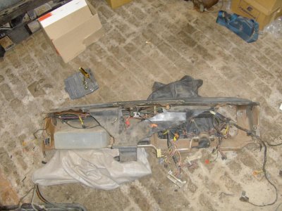

I've done 3 now working on my fourth,I always pull the whole dash that way you can inspect everything for future problems plus you can repaint the dash it self and fix all the cut up wires you will find. ;) You will have a really tough time doing it with the dash in the car because every thing will be in your way.
Here are some pic's that might help,if you need more just let me know.
BEFORE
DURING

AFTER

Nope, just remove the top speaker panel to expose the screws.There are 4 screws on top outer edge closest to the windshield (see 1st pic for locations),then a bolt on both sides of the dash where it meets the kick panel. If you look at my last pic you can see the bolting tab hanging down on the far left bottom corner.There are also support brackets under the dash that you will undo when you drop the steering column down.
