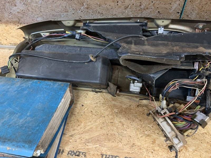

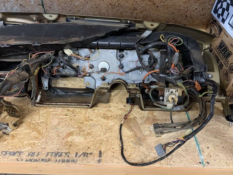

Remove the defrost duct,then the harness cradle, both have screws accessible from the top then you should be able to pull it out. I added a pic. It's kinda buried in there.
