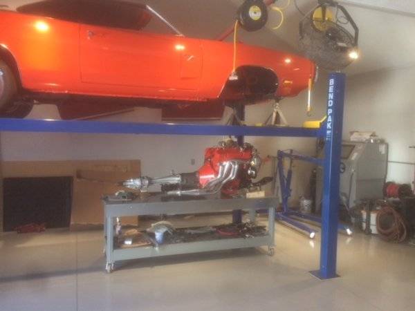

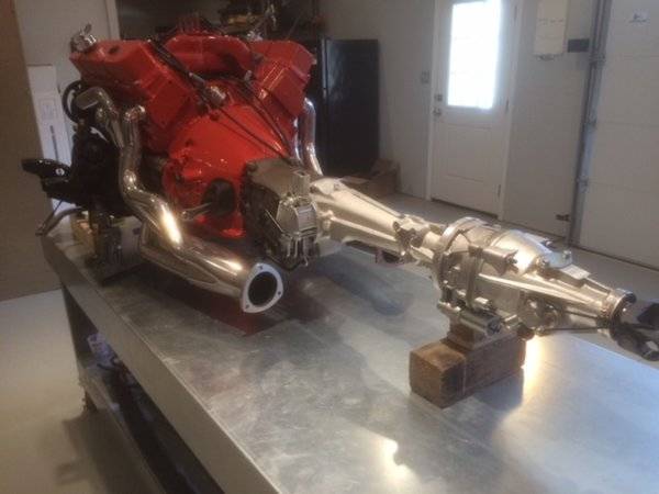

I installed mine on the bench. Piece of cake. Mine is in a '70 Charger, and I did spend some time adjusting the tunnel.

View attachment 537665 I installed mine on the bench. Piece of cake. Mine is in a '70 Charger, and I did spend some time adjusting the tunnel.

I installed the engine/trans/GV as a unit from the bottom. I had the car on the lift and the assembly on the bench in the previous photo. I just did it by trial and error until I had the clearance. I also slightly slotted the bolt holes in the cross member to drop the trans slightly.

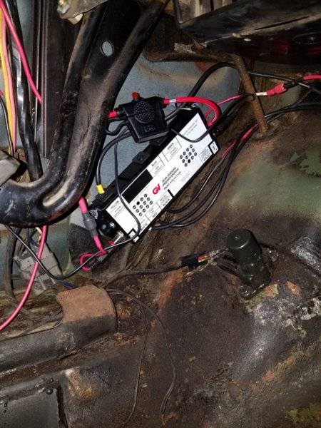

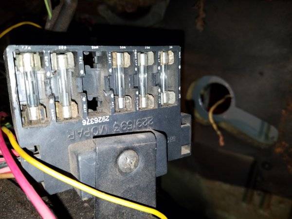

I installed the electronic control box yesterday. I'm not sure which fuse to tap into and connect the 12 bolt keyed source hot red wire to? There are only a few fuses to choose from and directions say it should be a fuse that is off during crank. Which one do I connect to and how does one connect to it?

So the 2nd fuse is what I should connect the 12 bolt keyed wire to?
I found the answer to which fuse to connect the live wire to in case someone has a similar question in the future. That's right I'm thinking about you right now :)
You can connect to the first fuse or the last fuse in the fuse box behind the glove box. Unscrew the fuse box with a philips screwdriver and turn it over. You should have an empty connector that you can connect to on the first and/or last fuse!
Thanks for everyone's help with this. More questions to come from me as progress continues.
