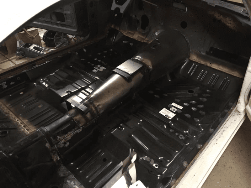

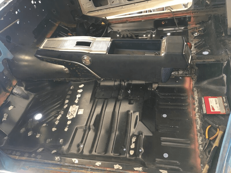

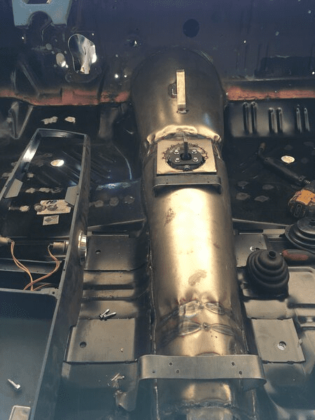

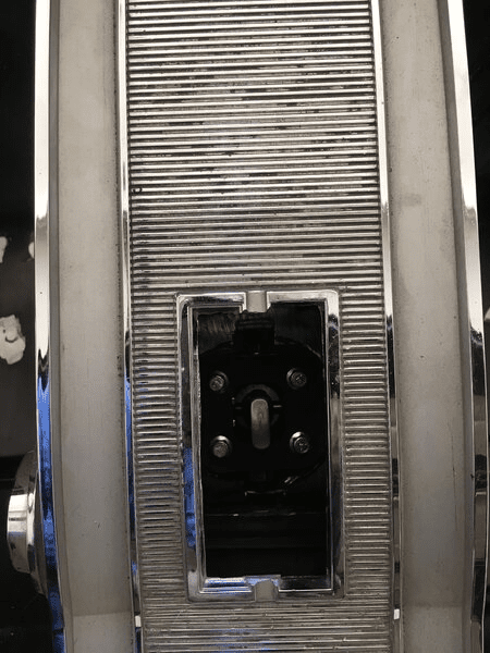

im doing 6.4 with mopar t-56 spec magnum in my 68 coronet . i had to re work the floor to fit the t-56 , i kept the auto console and just made new brackets

no kit they were way too expensive , made my own tunnel , cross member and converted my auto pedals to manual
the tr6060 has no slip yoke so you will need 2 piece slip driveshaft , will need a core shifter relocation kit and it does not have provision for speedometer so you will need gps or some kind of tone ring to get speedometer
