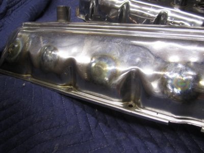

Thanks everyone for the good info. Looks like there are some good options. What cautions are there for valve covers fitting or clearing?
yea... that's what scares me! That's why I was asking. thanks for the pics. Hopefully is does not come to hammer time.
