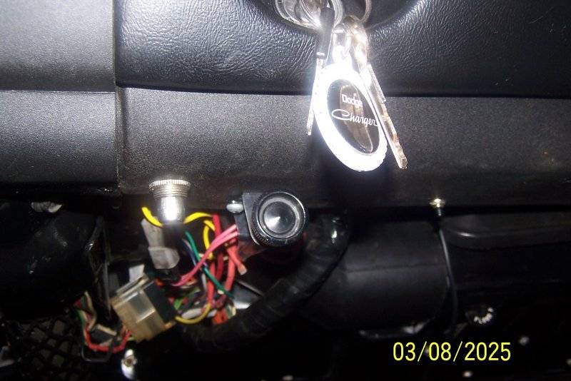

I installed a Gen III in my 68 Charger. The problem with using your stock 66 ignition from what I remember is the issue of the break in continuity between start and run. Apparently the Hemi don't like that and will not run properly. I tied the start and run together on my ignition switch and most times it would start and run great while other times it would flutter and miss fire. I wired in a hidden push button under the dash and it has worked fine since then with just putting the key on run then using the push button. Not sure if this helps you any but that was my remedy You might want to quiz Chris at Hotwireauto.com
