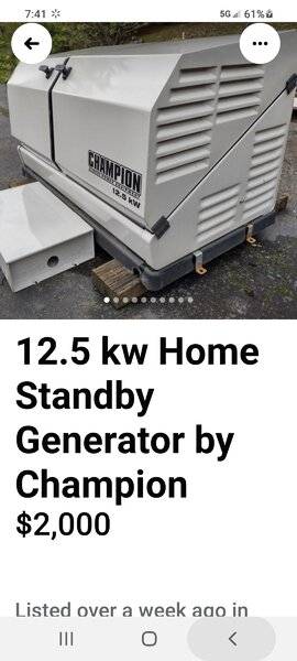

Here's one in Sebastopol CA.
https://www.facebook.com/marketplace/item/209137854683981/?ref=facebook_story_share

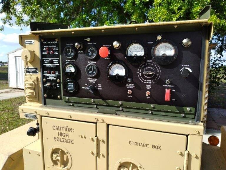

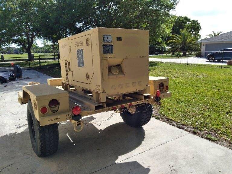

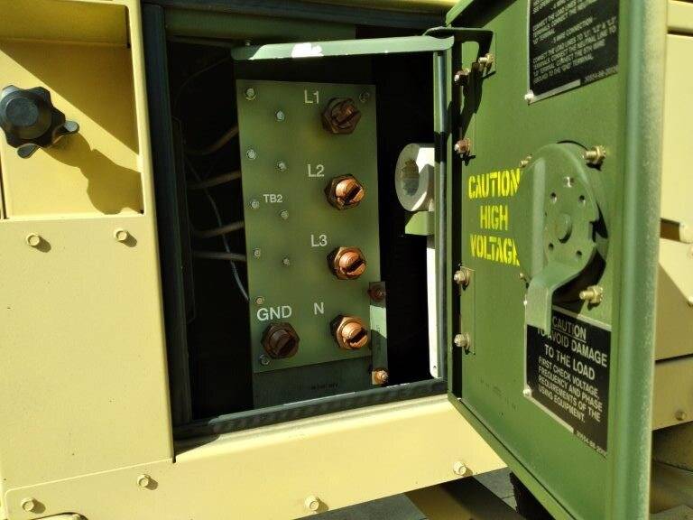

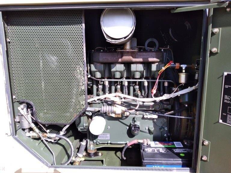

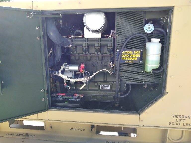

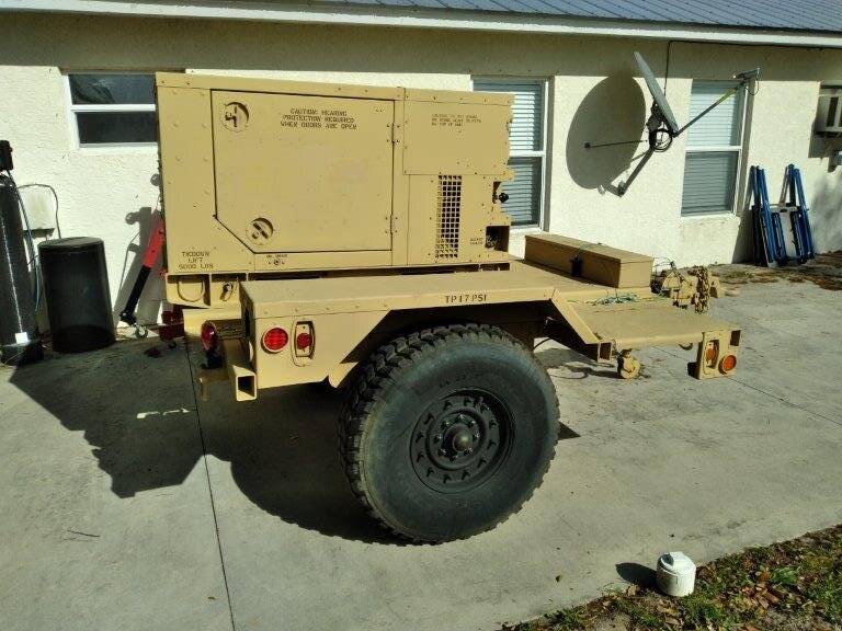

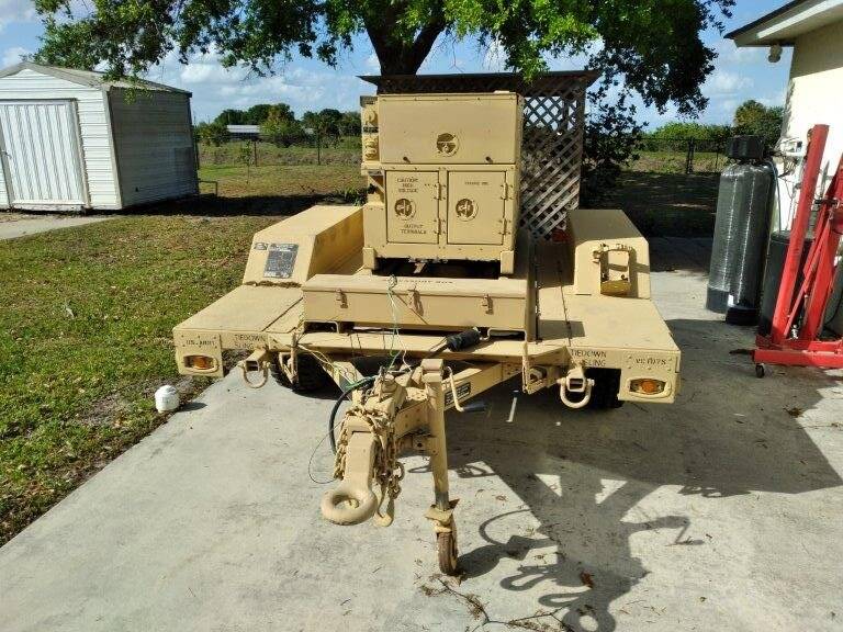

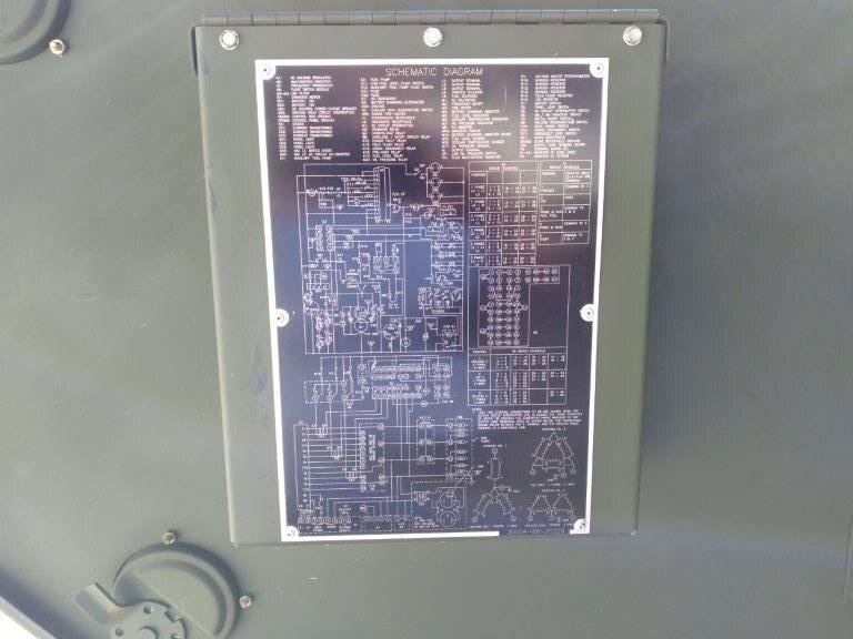

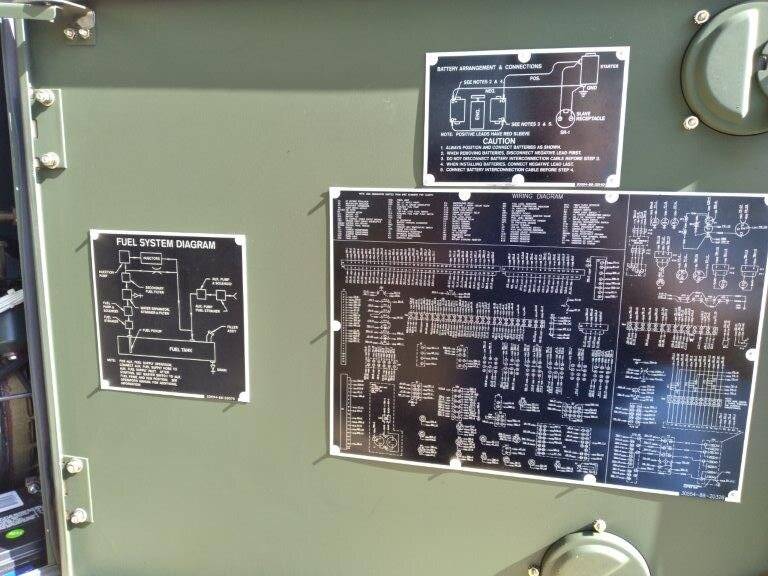

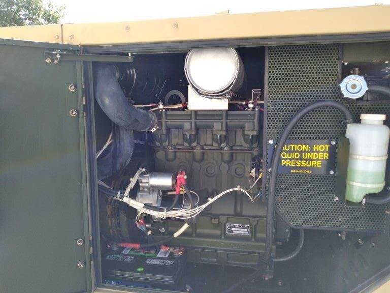

I've got a diesel military MEP-803A 10KW (rated to run 130% (13KW) continuously. It's a beast. It's on the military trailer too and since it's portable, no permits are required. I attached some pics. I paid dearly for mine (<100 hours on it) but you can snag these cheap sometimes.

I can appreciate the ruggedness of military stuff....afterall it was paid for by US, the taxpayers. Many years ago, during the oil embargo and local energy curtailments, by the utilities, favoring homeowners vs industry. The local solution, for industry, was to save power for homeowners, was to generate power for individual plant operations. My solution for the plant I was in charge of, was to lease two Caterpillar diesel generator sets and run them during on-peak energy consumption time. These Cat Generator sets were rated at 1000 Kw (KVA), 480 volt three phase and powered by Model 3412 Cat V-12 twin turbocharged diesel engines. When the generators were making max KW, the exhaust manifolds, turbo housings and exhaust stacks glowed red, with a 3ft. exhaust flame at the stack. In order to produce 60 Hz power, the alternators were 4 pole units running ar 1800 RPM, controlled by a Woodward mechanical governors to hold the exact RPM. The engines consumed roughly 75 -100 gallons of #2 fuel oil per day per unit, depending on load. Diesel powered generators are great and absolutely dependable, at least in my industrial application but were expensive to maintain and operate but the alternate was to shutdown and send everyone home......

I agree here. These units I hauled World Wide for the USAF and they were used extensively for power at remote air fields and in living compounds. They can be had for a nominal amount and sometimes for a great deal...cr8crshr/Bill:thumbsup::thumbsup::thumbsup::usflag::usflag::usflag:
