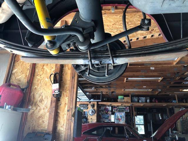

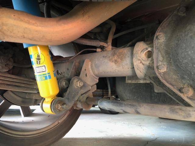

I wrote that the original springs had an overload spring on the bottom that was almost flat. The replacement springs have an overload spring with an arch to it BUT originally, it is installed with the arch inverted. Strange, huh ? It looks as if the engineers figured that in a stock configuration, the springs would be soft for a comfy ride but once the suspension compressed 5-6 inches, the overload spring would come into play.

I did the logical thing and reversed the negative arch:
This raised the rear of the truck up an inch at the wheelwell. It rides firmer now and does NOT bottom out. The spring surely will carry more weight before sagging.
In short, I blame the leaf springs for the majority of the problem. The shocks were getting old and did need to be replaced but the springs just didn't have the stiffness/rate to support the truck and the weight I was carrying.

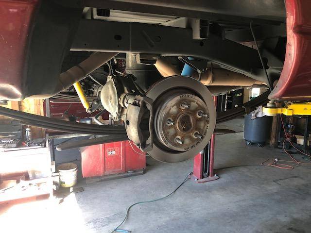

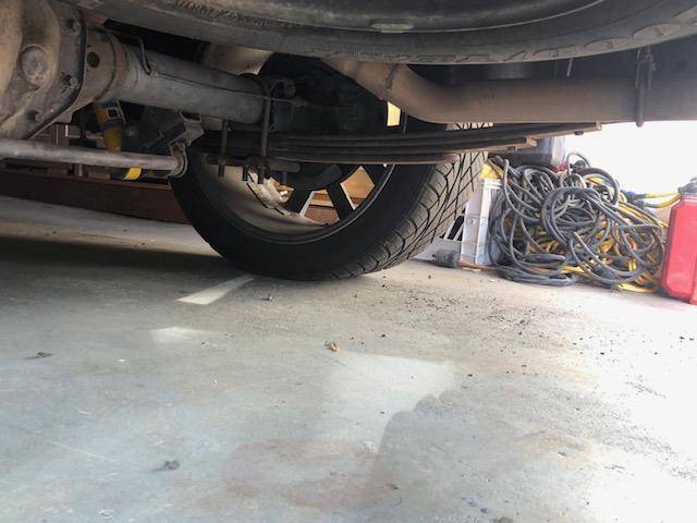

Beforehand, the bottom overload spring ends didn't even touch.
