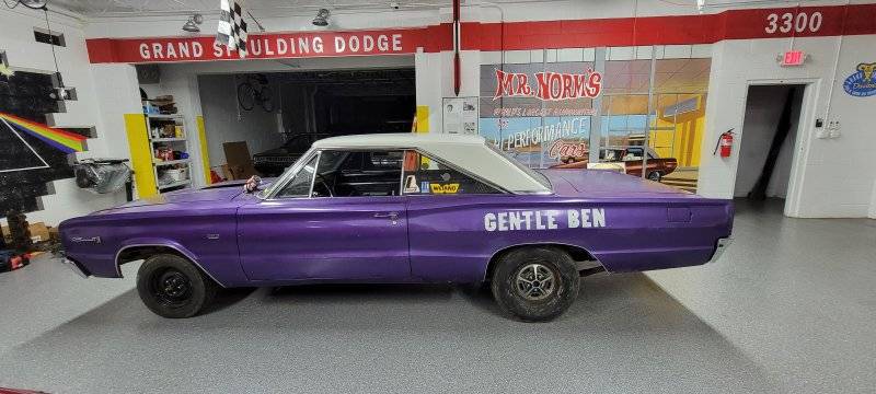

Update on "Gentle Ben" or the Coronet that shouldn't exist, but does and sold through GGS Mr. Norm. I have added move videos of the transformation this car is going through on my YouTube channel @AngryCylinders it has come a long way in less then one year. 4 different shops working on getting it done. The final transformation will be unveiled at this year's MCACM show. Last year it was a barn find and in one year will be ??
@AngryCylinders I am the new owner of the rare 1966 Coronet 440 with a factory 426 Street Wedge 4-speed "H" VIN. This car was advertised and sold through Grand Spaulding Dodge by Mr. Norm. What makes this car possible on of the rarest mopars is that it was a special order and pulled from the factory assembly line to get a special R&D treatment that included a 426 Street Wedge with a 4-speed. To add icing to its journey when R&D didn't need it anymore, it when to Grand Spaulding Dodge and got the Mr. Norm (Gary) treatment. The facts about this car are now well documented by a build sheet, data card, historical records, original owner's testimony, Galen's registry, the knowledge of Uncle Tony and other Mopar enthusiasts. The whole story can be read in other treads and Uncle Tony has a great narrative. I have put a few more pieces of its history together an may post a summary story in the future.
You can follow what I am doing to it at my YouTube channel @AngryCylinders . I don't want to spoil everything that is getting done but it IS getting a '65 period correct 426. The car is almost all torn down. The new engine is rebuilt and most of the hard parts are located. Still need a Chrome 426 Commando air cleaner for the Carter carb and nice front/rear bumpers. Hope the car will be completed for some Illinois shows in summer!
