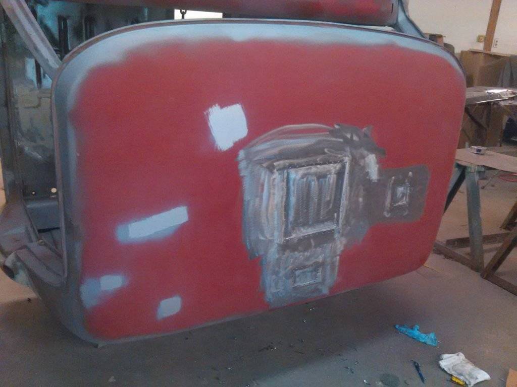

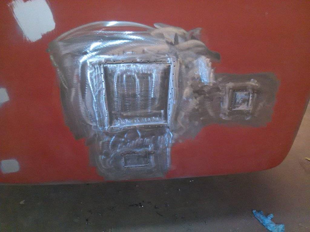

Looks like youll be fine.. patients is key, take your time.. you get those spot welds nice a flat like your above pictures.. it will be less work levelling it out..

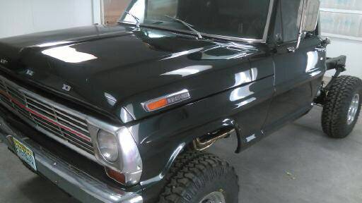

exceptions to the rule......... that Ford truck I did was a former fire truck and had multiple holes in the roof....... didn't want to weld a huge patch in the roof, panel bond to the rescue!

Nice looking work especially for the first time. Great job. Welding always over panel bond on the panels like you are doing. In the heat of the day it has been know to show its head. Doesn't expand like metal or something. Above my pay grade for what is chemically doing. All I know is I have seen it my self. Panel bond is for pinch welds. Especially say at the rockers for it's great corrosion protection. And as far as worrying about it coming apart. Let me tell you about the time I had to go behind myself year or so after I changed a bedside on a chevy truck. The only way it comes apart is to roll it like opening a sardine can. It was not worth the labor time the second time around I can promise you all that. Some guys have actually said they are scare of the panel bond make if the car too stiff. I don't know if that is a thing or not.

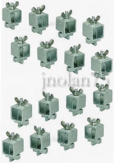

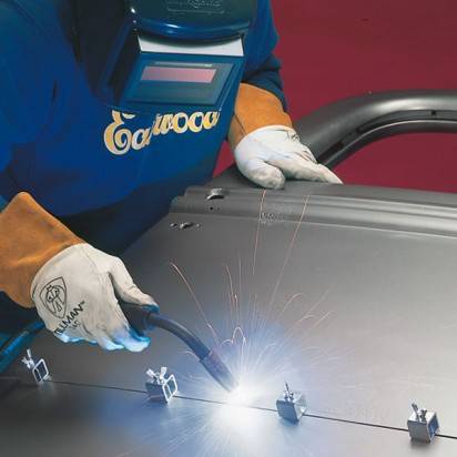

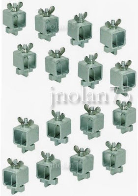

I use these sheet metal butt welding clamps when I do sheet metal repairs. It helps keeping the seam flat throughout the welding process.
