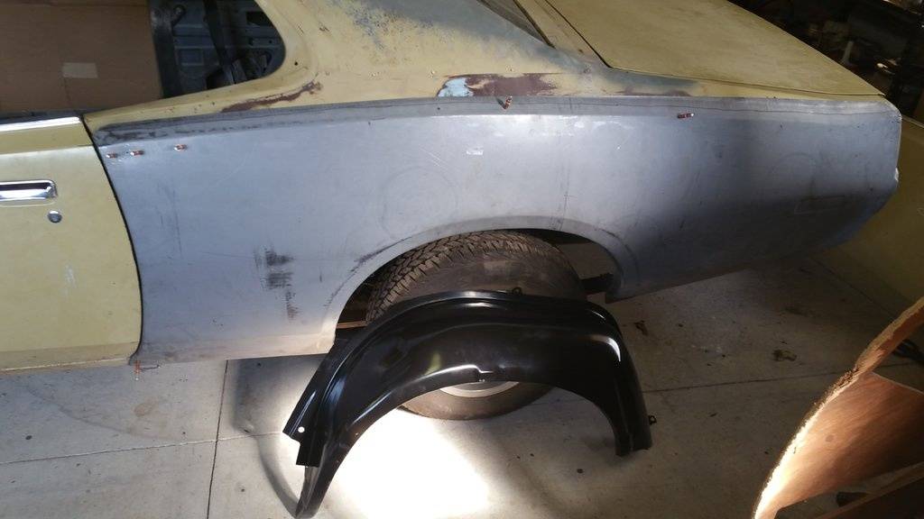

Hey guys, I've been working on the resto-mod of my 73 Hardtop Charger. Not a very rusty car at all, but driver's quarter panel was badly damaged in an accident many years ago (before I bought the car).
A new quarter was necessary. Full panels aren't available aside from new old stock, and many have had good luck with tabco skins.
The difference is that the quarter skin only extends about an 1 1/2" above the upper body line, and it's 19 gauge steel compared to the factory 18 gauge steel (I measured).
Should the upper edge of the quarter skin be slightly lapped onto the original remains to retain strength in the quarter (and make stitch welding easier)? Or is a butt-weld absolutely necessary? The car is going to be a very nice driver when finished, not perfect show quality.
It might also be noted that I live in a very dry part of the U.S. , and rust isn't a huge concern like it would be down south. Thanks, - David.
Quarter has been test fitted several times with good success, I'm just trying to decide the best way to stitch 'er in. Right now I'm leaning to buy some of these flange vise grips to flange the old steel, and weld the new skin into the flange. It should be very strong, and it would all sit flush on the outside, to keep fiberglass filler to an absolute minimum.
How would you guys do this? Thanks. -David

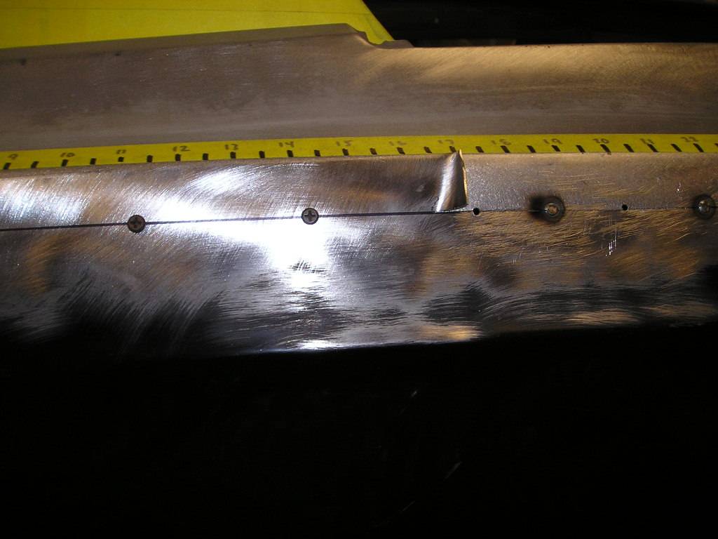

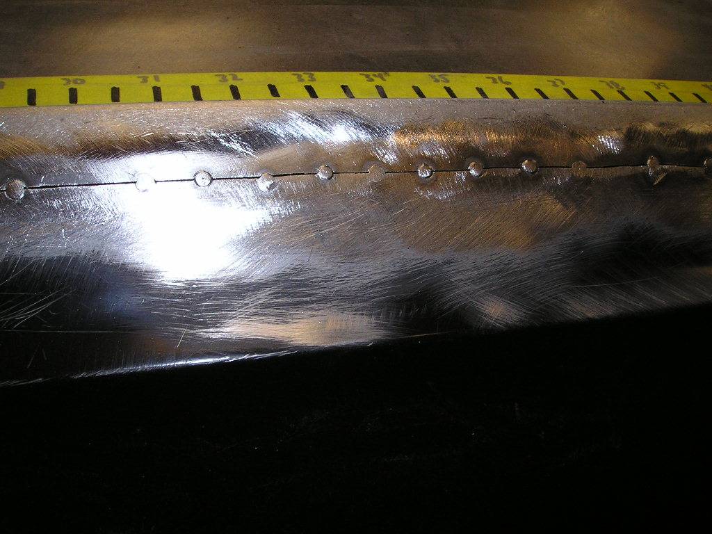

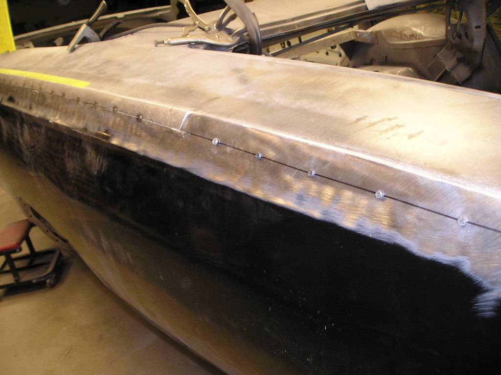

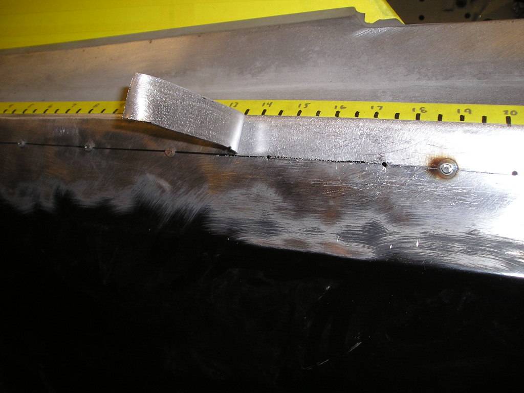

screw it in place where it fits best overlapping about an inch as high up as possible.......use a cutoff wheel to cut through both layers of the overlap, do a couple inches at a time......... this will give you a gap the width of the cutoff wheel....... tack every 2 inches or so using an air blower to immediately cool the welds......... once it is tacked the entire length, go back and fill it in one tack at a time, skipping around and cooling
I would go at it at the upper lip of new panel . less area to warp .. thats just me though.. for the most part I agree with the above.
yeah.... over the body line works just fine....... I like working tight to that bend though
Neat idea with the cut off wheel sized gap. Doesn't sound too bad at all! Maybe if I wrapped some copper around a dolly and held it behind where I'm welding that'll prevent blow-through? Thanks - David

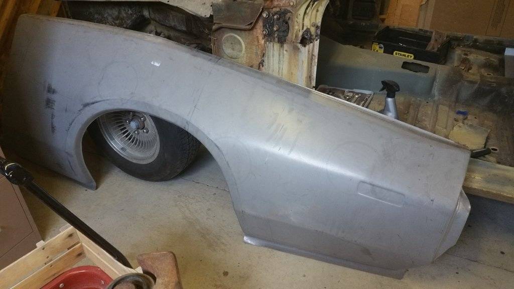

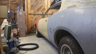

This is how the new quarter fits as of now. Should be really close.
This is my first time doing a 1/4, and I want to do it right with the best of my ability. Not too bad for a 19 year old without any guidance besides the interwebs.
your welder should fill that small gap with little effort

I use 030 for everything......... remember one tack at a time..... keep em small as you can
practice a little on the old panel first, cut a slice and weld it up
Yup I understand the whole tack welding the entire piece in to prevent warpage, rather than a continuous bead. Should be pretty simple, but will take quite a few hours! I have .030 wire in my welder currently, glad to hear I shouldn't need to change it out. Thanks - David
It will help if you dress the weld beads with the edge of a zip wheel every now and again too. I like to hammer and dolly as I go in between rounds of welding.

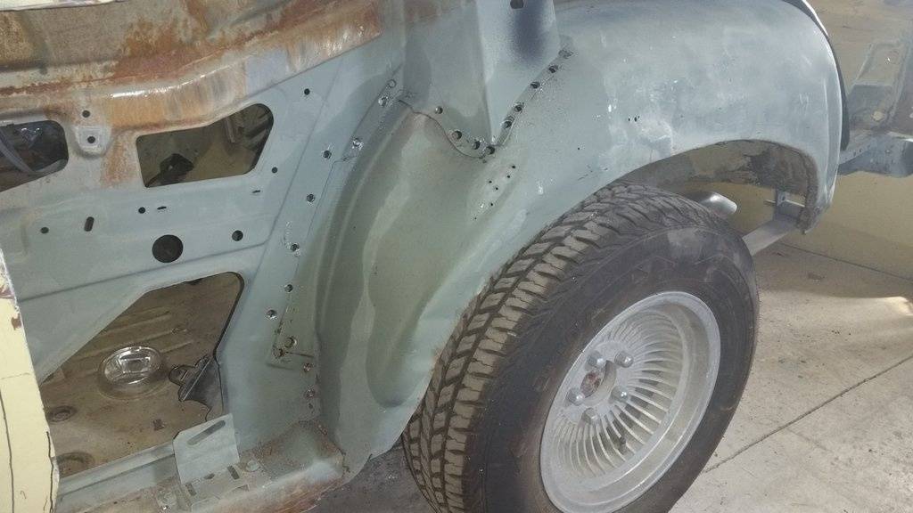

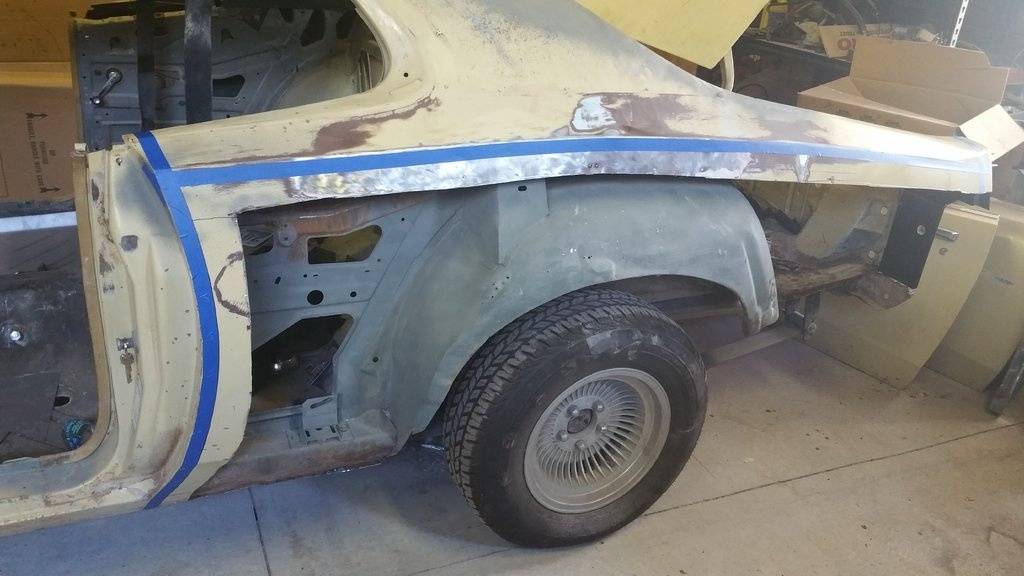

Well looks like I have quite the task ahead of me. I don't have much do left before the quarter goes on for the final time.

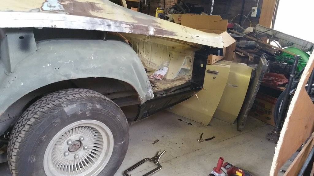

what does your outer wheelhouse and trunk dropoff look like?
Brand new from AMD. Almost done removing the old wheelhouse, but trunk drop-off fits great. Pictures coming in a few minutes.
First photo shows the start of removing the old wheelhouse, new one will be plug welded in to somewhat replicate factory spotwelds.
Second photo shows the new wheelhouse, awaiting installation. It looks identical to me! Even the "M" stamping towards the back is there.
Third photo (posted previously in this thread) shows the fitment of the AMD trunk drop off on the car.
