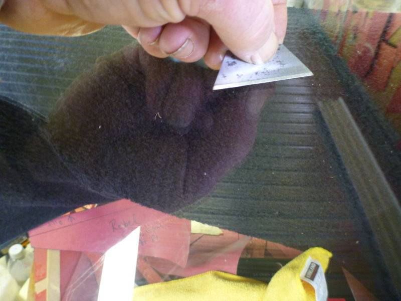

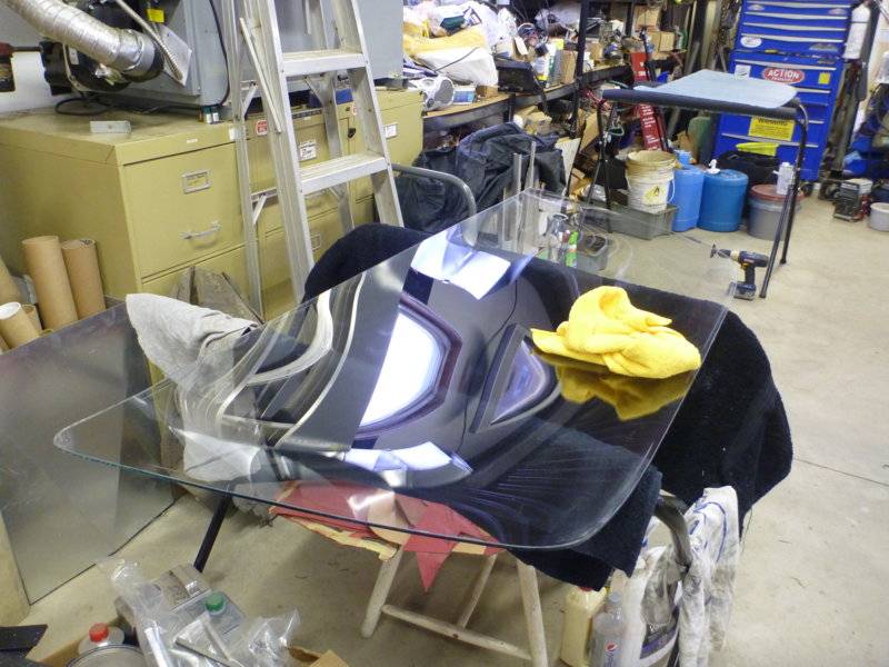

One other offering after spending another afternoon working on glass clean up. I've found running a carpet knife blade back and forth across the glass, held TIGHTLY on about a 45* angle will take the ridges off the scratches and stone dings and make them less visible.

I did the same thing what dadsbee said with the blade. After that, used 0000 steel wool and believe it or not, vinegar and it works! Then I used glass cleaner.
