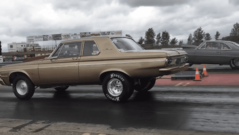

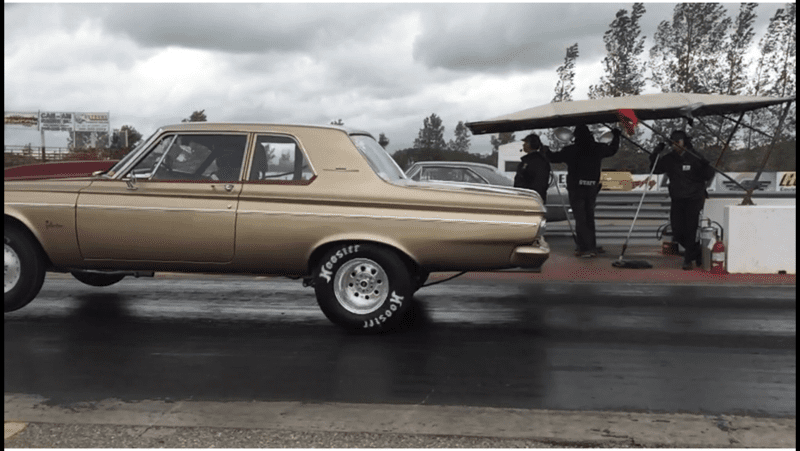

A couple of pics from 2 seasons ago. Glad those issues are done with.
This pic is about 5 - 10' feet out. Front coming up and all is starting out good but rear end separation is also in motion.
Same race, now about 30 - 40’ out. Front is down and rear is up. Rear tires pretty much off the track. Then the rear would come back down and it would start all over.
Was on Split monos, cal tracs, QA1 dble adjustables front and rear. Glad those days are gone.
