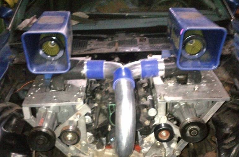

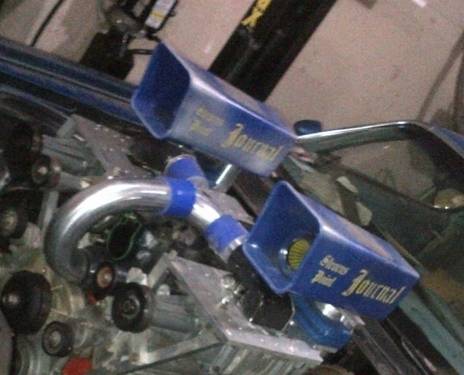

t That being said 5 passes in for the weekend in the hot humid air with a DA over 2000. Saturday my 1st pass was through the exhaust and 10.16 with exhaust out the back bumper with 4 lbs of boost.Uncapped the dumps and it went 10 oh something on the lean side.So I upped 2 jet sizes and gave it 2 more lbs and it went 9.9.
Sunday morn 1st pass was 9.7,2nd was 9.6,3rd was 9.8 and last was 9.6 with 10 lbs of boost:moparsmiley: No matter what I did it would only go 140 mph.Moved the timing around a little with no improvement.

I am rather disappointed with my performance.No matter what I tried it wouldn't go over 140 MPH even with 10 lbs of boost and open exhaust:mad:My IAT was as high as 180*.
I have to find out at what temp the power starts falling,,,,,I think I was there!:cursin:

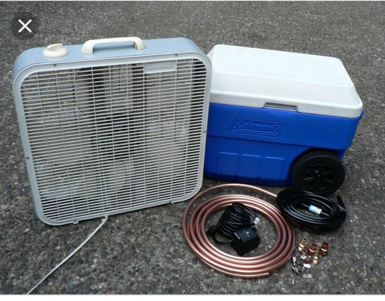

Maybe you can adapt this to your needs..
