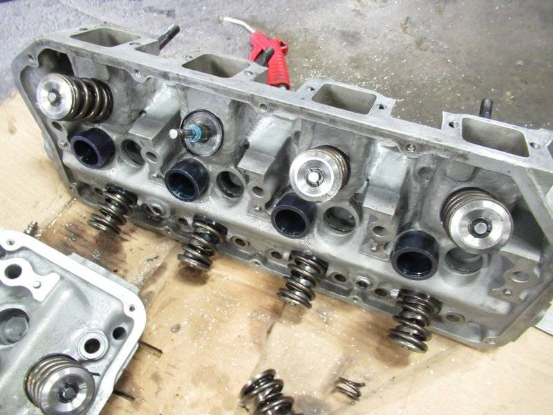

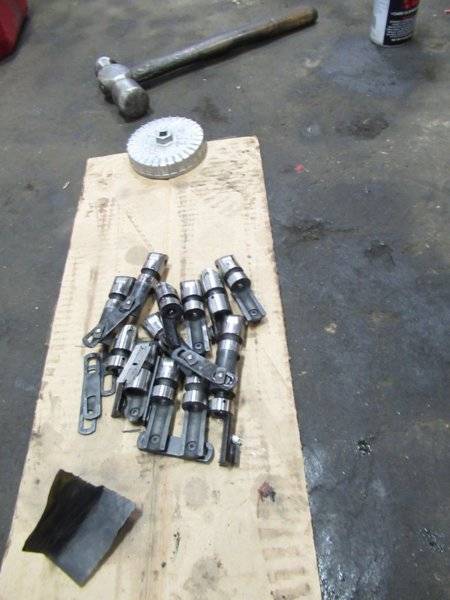

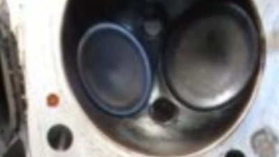

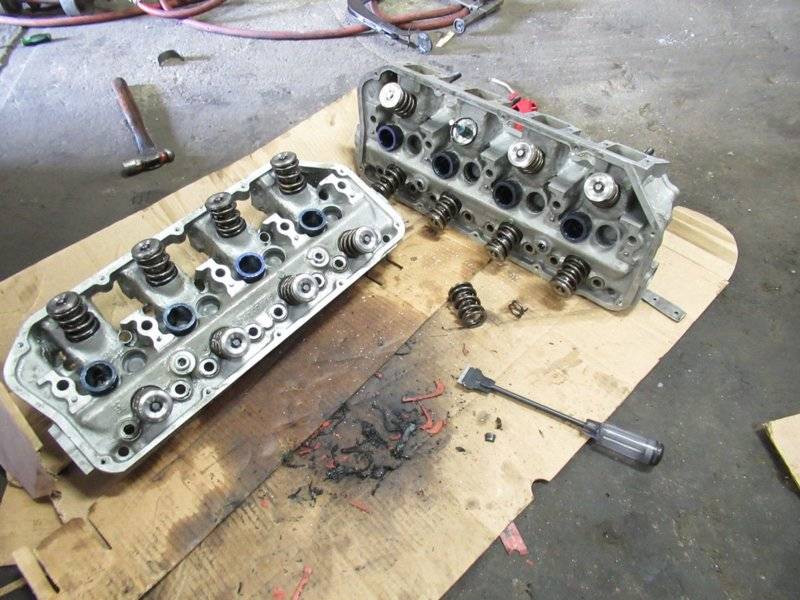

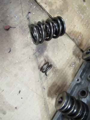

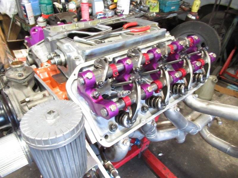

. The lifters came in on Friday and we reassembled the short block and replaced the inner spring,also advanced the cam to 5 *.Checked the spring pressure and it was 230# on the seat and 648# at .650 lift.

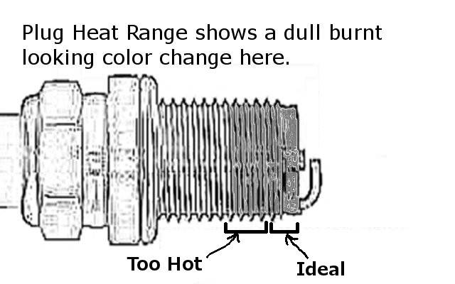

I have 2 threads black which is good but not the change in color of the strap on the plug.
sorry if some of that is overly ****...
looks to have come around some 9.67
(was that 146.8 mph ? -14..68-)
how far down the threads (on the plug) does the discoloration go ?
can't tell really well, looks a tad bit rich, I can't see down inside
but IMO that's not abnormal for blown gas (gas in general)
especially if you idle around a bit
especially if you didn't click it off clean, right after the speed traps,
for an accurate plug reading
I assume you drove it back, then checked
just curious
compared to your previous data
what did it tell you ?
did you do anything with the timing ?
where you at now ?
can you change when it comes in ?
or take timing out down track, run more initial ?
kept getting faster as boost was added
that's a good thing,it liked it
I say do more
Just noticed this mistake,it's .640 lift with 650# over the nose. 230# on the seat.Comp roller mid .600 lift with 350# of pressure over the nose.
IQ52 aka Jim LaRoy said he would only use solid lifters (whether roller or flat tappet)
