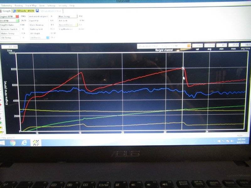

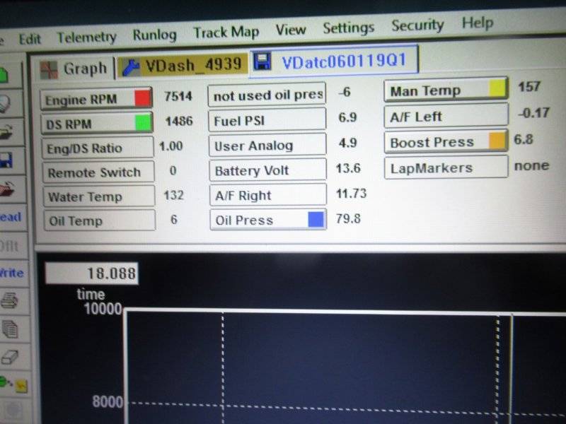

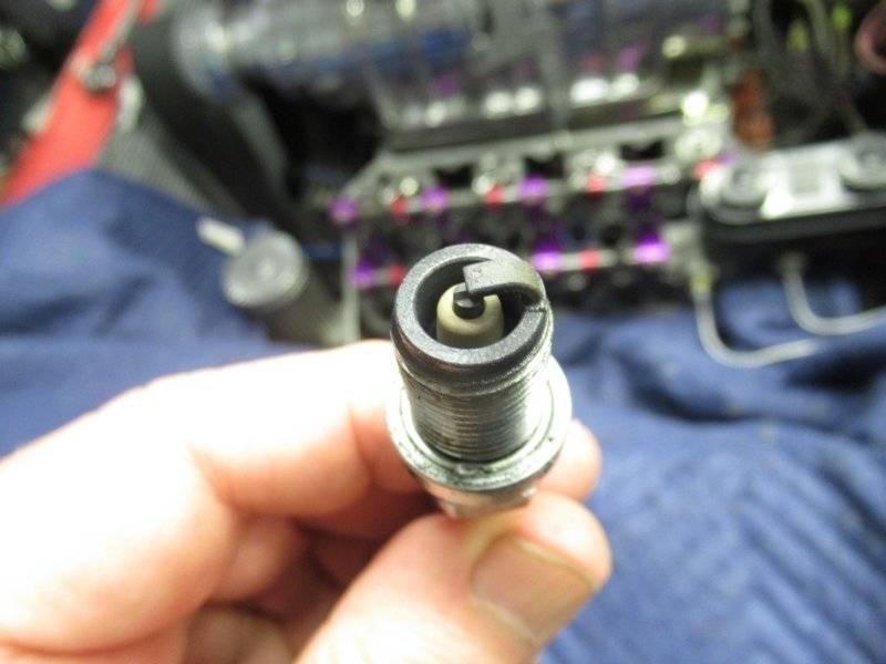

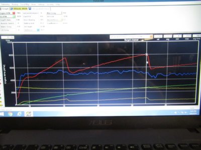

Have a Racpak logger dash. O/2, D/S, O/P/ ,F/P,Boost and temp sensor in the intake.
13.0 at WOT.MSD 6AL-2 programmable box with MAP for boost retard.
Car was hooking on 10.5W MT E/T drag tires,,,,60's are till sluggish in the low 1.4s,,,tight converter.
6500 over the stripe,best pass is still 147 mph. Went to Atco for the weekend.Still had some pump gas in the cell so 1st pass with my street tune was 10.16, UNcapped it went 10.05ish.Poured 5 gal of C12 and changed pulley for 6 lbs and netted 9.9 and that was the end of Saturday.
Changed timing and upped 2 jets Sunday am and 9.82 @139 with 6 lbs.Up to 8 lbs 9.73 @ 140,,upped to 10 lbs went 9.67 @140
