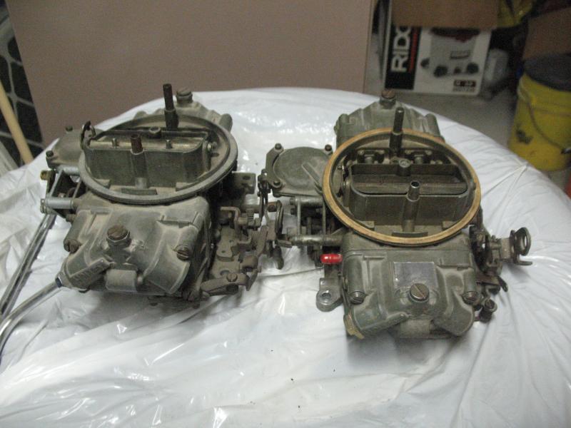

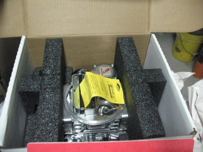

If your looking to purchase, I have 2 3310,s for sale as well as a brand new in box Quickfuel HR-680-VS. I,m running efi now. I had a 950 Quickfuel on my 440 stroker and performed flawless.

The 3310 and 3310-1 were equipped with secondary metering blocks (with jets) and drop-leg boosters. The 3310-2 and all it's successors used a metering PLATE and had straight boosters. From a performance and tunability standpoint, the early carbs are more desirable.
