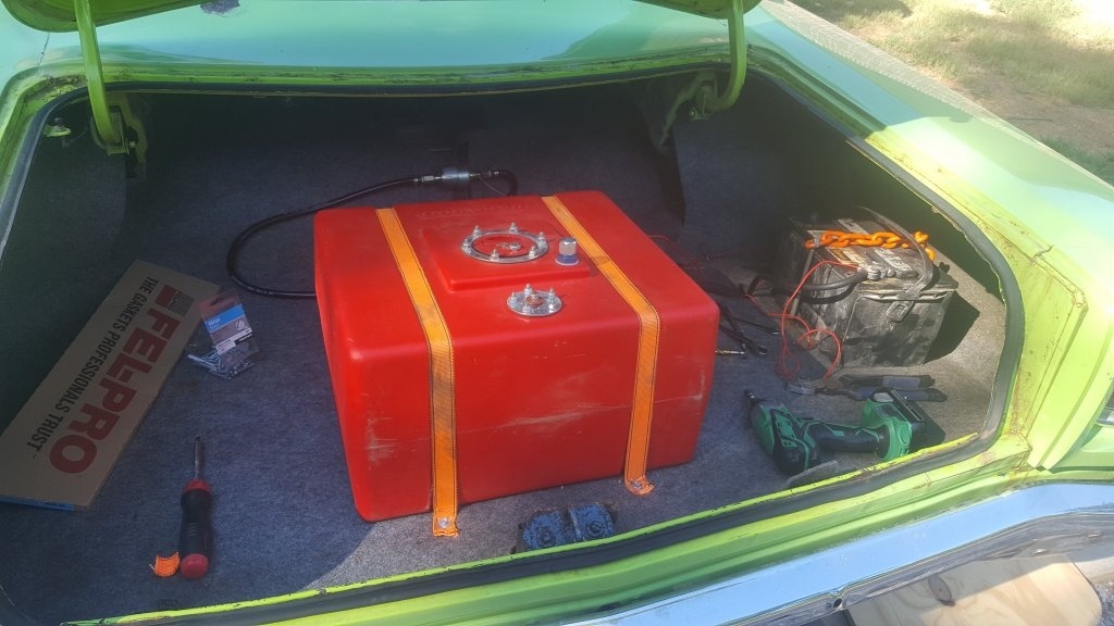

2 questions: is that a boat gas tank in the trunk in place of a 20 gallon stock tank, and is that an accelerator pedal in the shape of a foot
if so, that is extra sweet and hilarious. I wouldve paid 8500 all day long.

Yes and Yes! It is a little scary when the trunk smells like gas fumes and you have to hook the battery cables up everytime to start it because the brake lights stay on! But thats just how I roll!!!

Correction to all who cares. Just read the vin again and realized its just a satellite not a sport satellite. On the bright side as of today I have insurance on it, Searching for a fuel cell locally now =]

Got a fuel cell installed instead of the old boat gas tank. Also bolted the battery down. Right now the header studs are the Bane of my existence. The headers are welded to the pipes. So, There is no way to drop the header with the studs in place. Of course I had to break one off replacing the exhaust gasket that was leaking. Guess I need to go buy some easy outs.

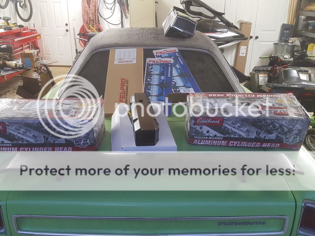

Also Met an awesome guy on the FB mopar group im in and scored a set of ported edelbrock aluminum heads, Ordered some fab'd vlave covers to go with them.
Also added a 750 mighty demon double pumper to take place of the old 750 holley single.
Shooting for 13's
