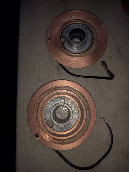

I am having a problem with the adapter for my Grant Steering Wheel eating my Turn signal switches. The adapter horn ring wears out where the horn wheel contacts the copper service
in a matter of a few weeks the little wheel will wear through the conductive service of the horn ring and eventual short out.
I have replaced the adapter kit twice and I just put the 3rd turn signal switch in the car
I first thought it was cheap switches so this time I bought and put in an NOS Mopar Switch. But not wanting to tear up a good switch I paid very close attention to the reassembly of the adapter kit and it appears that the adapter kit goes in too deep, forces the horn contact wheel to bottom out and puts too much pressure on the contact disc wearing it out. I considered shimming the contact disc out but then the cancel pin doesn't contact the TS cam correctly.

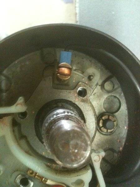

Had the same problem. Fix is simple. Go to your local Radio Shack and buy a plate of PCB (printed circuit board) cut it to the same shape as the existing plate and install it.
Look very closely at the roller wheel and its freedom to move as well as the direction its facing. It has to be able to freely roll against the plate. Also, mine had a spacer on the column to space everything correctly so the hub wouldn't rub etc. The "Grant" spacer was about 1/8 to short so the collar rubbed the column AND there was also too much pressure on the roller wheel.
You can see the copper shavings in the photo

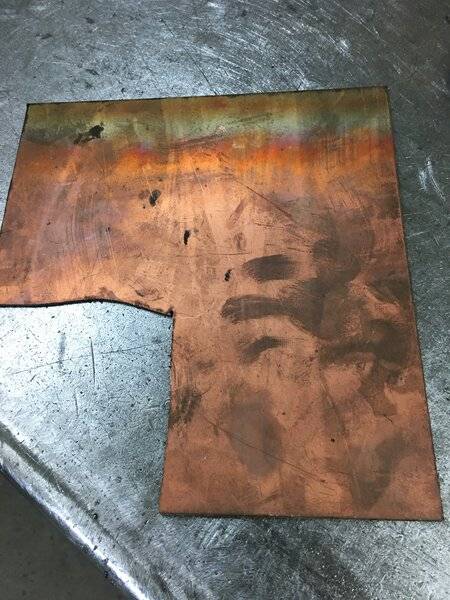

Here's a pic of the PCB material. Its copper coated on both sides so if down the road it wears off again you can just flip it over. If you need a piece I can cut a send you a piece.
Here's a pic of the PCB material. Its copper coated on both sides so if down the road it wears off again you can just flip it over. If you need a piece I can cut a send you a piece.View attachment 1160742
what thickness is this board?
I can get some from amazon but there are way to many Thickness listed.
also what did you use to cut the board?
Thickness is around 1/16" ... same as the original or pretty close to it. I cut the center hole with a hole saw and the outer circle with a bandsaw. You could do it by hand with a coping saw. You could probably do it all with a dremel too but these are fiberglas boards and the dust would be everywhere.
