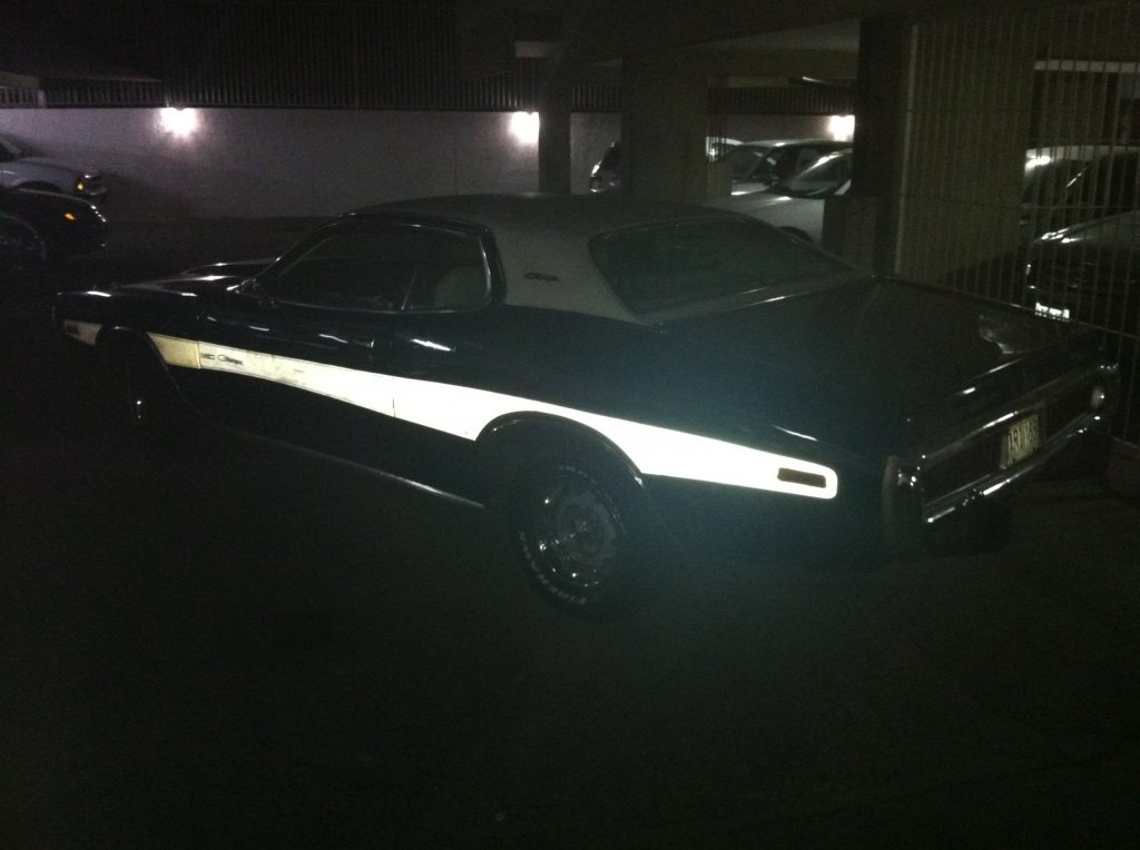

It custom, made locally with 3M 680 vinyl. Originally just solid black and the three reflective and phasered colors ( "Gold", "copper" and red ) were the ones availables.
