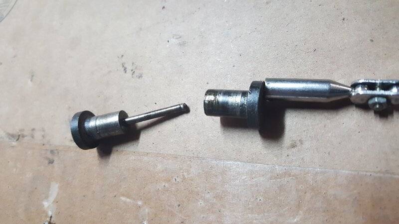

The thrust buttons MUST be removed. The axles will not go all of the way in otherwise. If you are lucky like me, the retaining pin thru the buttons is out or loose, and a long telescoping magnet will remove them thru the axle tubes.

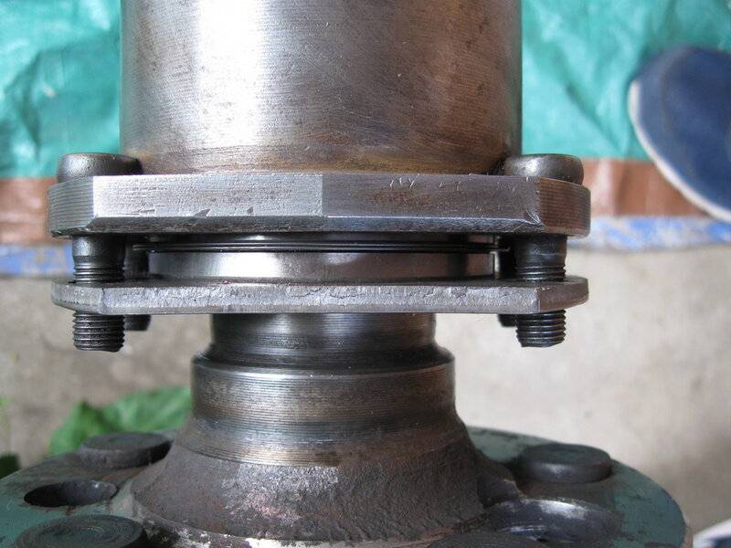

The buttons can stay right where they are , I had the same problem when switching to green bearings . I just cut off .080 on the end of one axle and life was good.

before you go to removing metal from the axle spline check to make sure the inner axle seal is installed to the proper depth -- if it is not in far enough the lock collar for the bearing will bottom out on the seal face ,, which will destroy the seal if run that way --- seal depth should be 1.675 -1.700 from the seal face to the face of the housing flange ---there is a inner lip in the housing end that the seal will bottom against if installed properly.

I bought the newer style flanged axels (with green bearings) conversion from taypered, from Dr. Diff and he recommended removing the buttons.
If you're lucky, the pin that holds the two buttons in the thrust block is broken and you can extract them with a long magnet. If the pin isn't broke, you have to use a small punch to drive the pin through the one button. You have to examine which button has the pin's head and which has the expanded end. The expanded end is the end you want to drive out.
Well I decided to just get the thrust block removed by a great local rear end shop who did it for $30 (I don't have a dial indicator). I already have it back and after re-reading this thread I realized what the problem might have been. I have everything out of the car and was mocking things up on jack stands beforehand to check the fitment. But...I hadn't yet removed the old inner seals so maybe the inner seals were holding me up that small bit? I have since removed them but measured first and both sides were exactly 1 3/8 in from the end of the housing. It seems like the new seals need to be a bit further in (1.675 -1.700)? I plan to put those in today and hopefully have everything reinstalled (leaf springs, shocks, etc.) by this weekend.

like i said in post #11 -- the seals must be installed to the inner stop to clear the lock ring on the bearing -- 1-3/8 is NOT deep enough. i've seen this numerous times on housings that have come in and helped a fellow on the A-body sight with the same issue recently.
