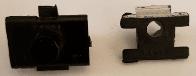

I've posted searching for these friggin clips before and thought I finally found them and purchased; but opening the envelope CRAP the wrong clips! I've searched tons of places and no luck. These are to retain the trim along the quarter glass (convert) top body moulding. The body inserts are offset as it lays along another trim piece for exact positioning. The clip on the left is what I ordered...if anyone has a line on correct clips or other clips they may have used appreciate hearing. I was thinking possible offset scissors type clips but haven't experimented with this as yet...this will begin my desperation phase. There are only six of these on the car; three on each side.

Thanks much gents for sending me some more possible places to find these damn clips. Sad to say on my end, biz must be good for the outfits I checked with as I got no reply not even just to tell me "nope we don't have". Meantime I'm hoping I came up with a remedy to try when I get the car back from the shop. I have some extra trim parts for the Fury doors (top trim) with the wire clips still intact and will see if they will work. I can't see why they shouldn't as they retain the identical dimension and location molding on the doors that align with the quarter window molding. The clips are positioned off-set in the trim channel as is necessary to set over the trim beneath (reason why those H clip inserts are off-set). Will see. Can't tell you how many friggin hours I have spent searching for those clips. Well, wish me luck and thanks again for your help.
To update my old post for those who might be curious, I got some luck having some extra top door trim parts in my attic. After all the brick walls on this I knew I had to find another type of clip; but then it struck me that the outer trim molding on the doors are identical to the quarter moldings! Those however have the scissors type clips but for some odd reason the rear had these nylon "H" clips with offset button (above pics) impossible to find. I climbed in my attic to see the door moldings still had the clips and set them in the quarter moldings achieving a perfect fit! Why Chrysler had the H clips just for the 1/4 molding I'll forever wonder...
