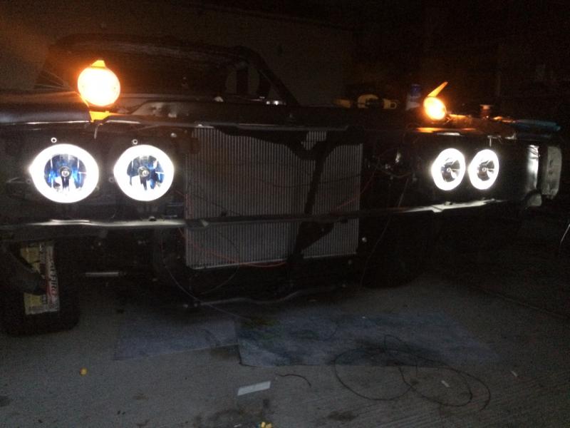

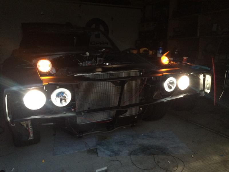

so does anyone know how to setup the headlight switch in 69 charger so that the headlight doors open when u turn the park lamps on? I have halo headlights and have them wiring up to my side markers. So I can have the halos showing with doors open?View attachment 288581View attachment 288582

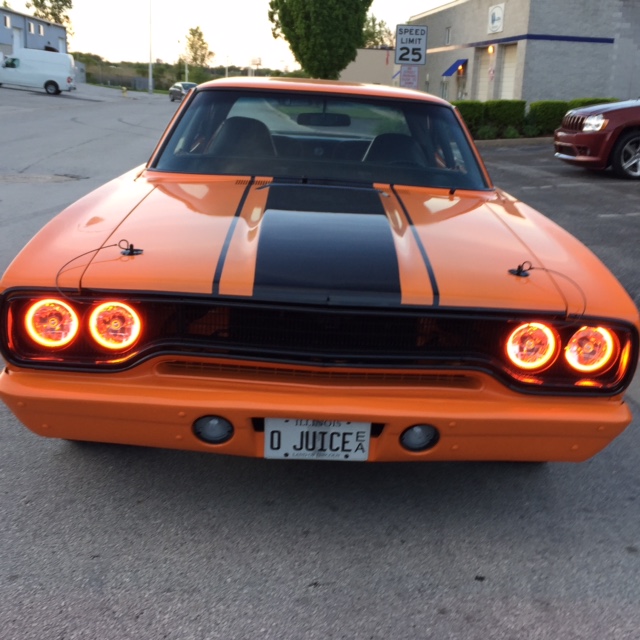

Don't know what experience Jason got with the octanes but I got mine from oracle lighting in Louisana. Oraclelights.com is the link. or Toll Free @ (800) 407-5776. They are more pricey then the octane but the results in my opinion are better. they're about $75-$85 per light(depending if on sale). you then have to buy the HID lights kit also. here's a pic of mine with just the halos on. I have the HID bulbs 8000k which is white with a very slight touch of blue.

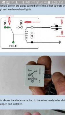

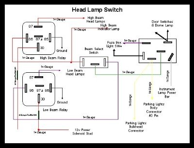

Huh! Learn something new every day! Haha that's pretty cool!Not true, vacuum operated solenoids off of a Ford truck (used to engage the 4 wheel drive) will do the trick. Just did a thread that would do the trick for you, use Ford vacuum solenoids using the parking light wiring as the trigger to a relay...... all done. Already did it to mine but mine runs off of the headlights using diodes to prevent backfeed, cleans up the hoses and also let's you run a more readily available headlight switch as well.
