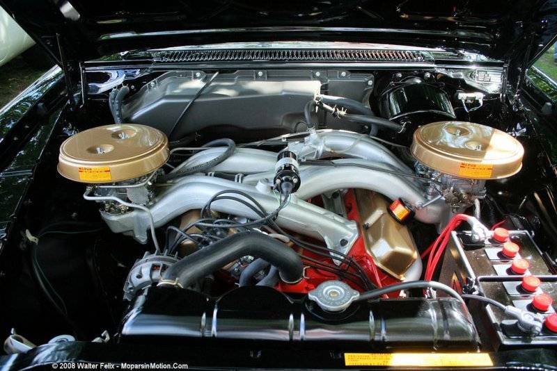

I'd sell the Poly and buy the 413, if it fits (and it's the one in the photo). It looks super cool.

not the one in the pic ... but you get the idea.

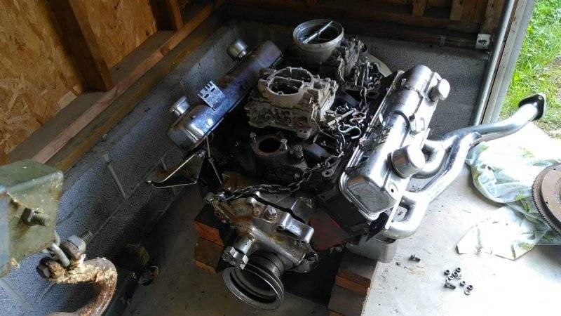

maby i post it tomarow with pics of the carbs linkage air cleaners and such. see whats up. mite buy the bb and shelve the poly for something later. i got a hornet shell that ain't doing anything.....lol

ok .... looks like another boat stopper 413.... but i got most of the long ram and a set of 915's.not sure thay are original to the 413. so i got the 440 and the 361. gona save the poly. the tal deck will be a pain but doable. (hurst used a BFH to make a LO23) the low deck looks to be easyer but will it be to low on the inner fender that will take even more BFH work??
still have the dual quad in line set up for the 361 .. so she will have dual carbs no matter what. guess we will find out ...lol
