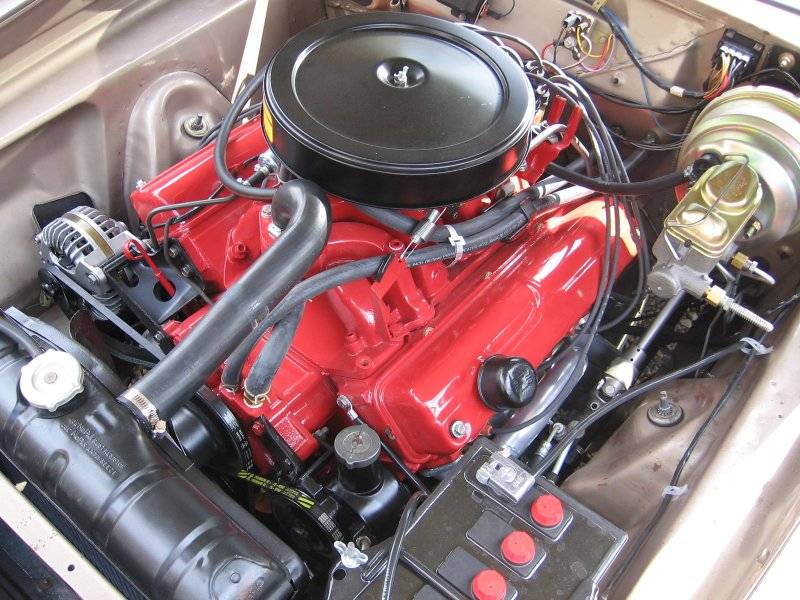

Parts for this one were sourced thru Gary.It was stroked to a 390. Also at the time Chrysler Power Magazine that is now gone.
Chrysler Power may still be found on the internet archives
