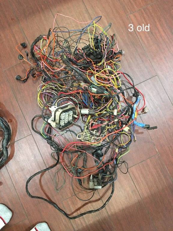

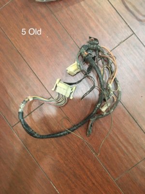

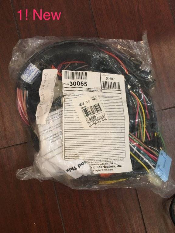

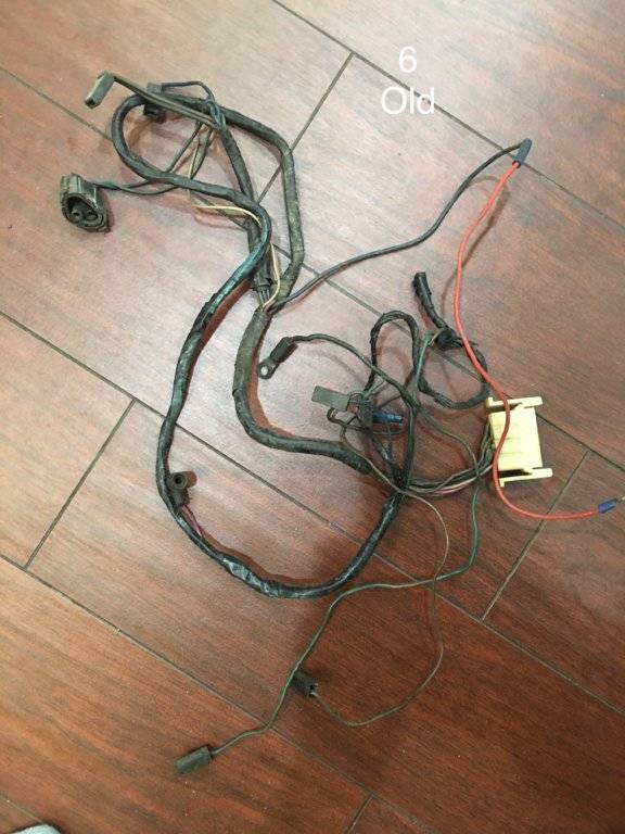

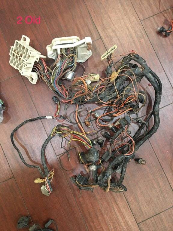

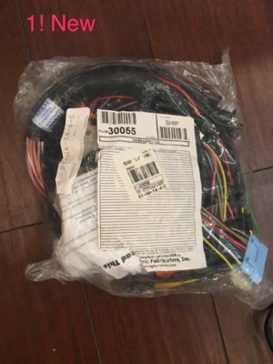

I have a new harness I bought from YearOne, and harnesses I got with my project. I want to sell what I don't need at the CPW Fall Fling. Looking for any information, what I should keep, replace, price I should sell each for, etc...
Pictures:
1 - New Dash Harness. Keeping.
2 - Old dash harness
3 - Another old dash harness

Definately keep everything until the new one is in! I'm doing the whole car right now and there have been a couple things I've needed to refer too and even stole a couple fittings that were good and use because the new kit didn't supply!

5 B/E forward lighting harness ( cut ) mixed with NSS harness plug? ( probably 71/72 B body )
6 B/E body engine harness.
WITH NUMBER 6 exception which can be easily rebuilt, the rest of these 3 are just for parts
2 and 3 can be also rebuildable but hard to tell from pics, specially 2... both seems to be B body Rallye dash harness... maybe 71 or maybe 72/73. Definitelly not 74
AWESOME!!!! Thanks!!!!!!
