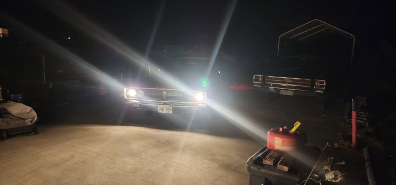

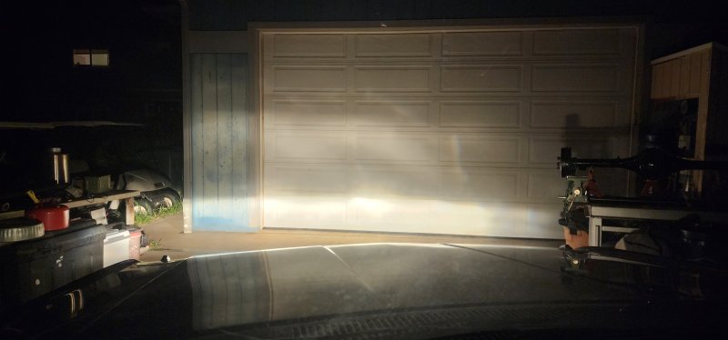

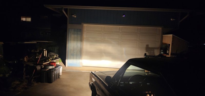

So there is a slight down hill slope going into my garage. But you can see there is a a cut off line in the light I would say about the same
as the original lights. Also note these are the classic white style.
View attachment 1869251View attachment 1869252
That appears to be effective and likely very friendly to other drivers. Thankyou.:thumbsup:
I a number of years ago purchased and installed this 5x7 Grote LED headlight in our truck fleet. They were priced higher years ago.
I was very impressed with the light output and it's beam control. I was uncertain whether the same beam control in the smaller round 4 lamp systems.
I have already purchased the bright white Holley's, but yet to install. Your pics allay it appears any of my concerns about beam control.

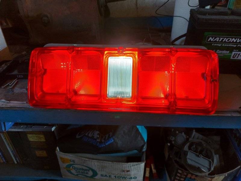

I used the Phillips LED bulbs 1157 Red and 2 LED Flashers. The below picture is just the running lights.

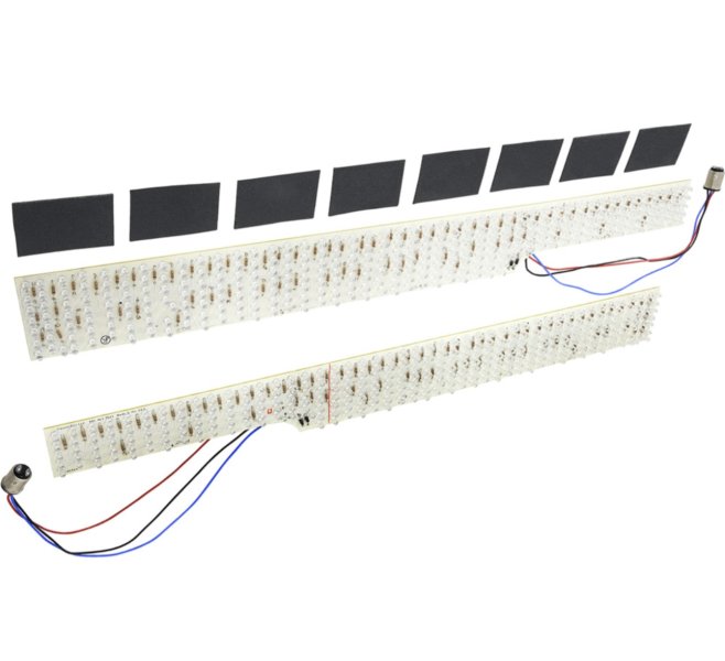

Looks like Classic Industries has rebooted an older design of LED tail lights for the 69-70 Chargers. The wiring plugs right into the tail light socket. Non sequential.

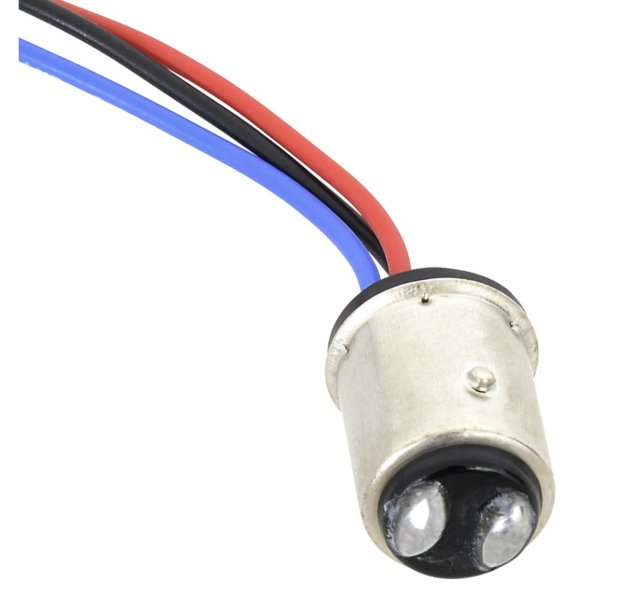

I bought LEDs from Classic Industries for my 67 Charger. Bought them for taillights, back up and front turn signal/parking lights. I also bought 2 led flashers for regular and four ways. For a couple of bucks more they offer polarity adapters, which I bought (and needed). Everything works great and they are much brighter.
Polarity adapters, what are they and why do you think you needed them?
