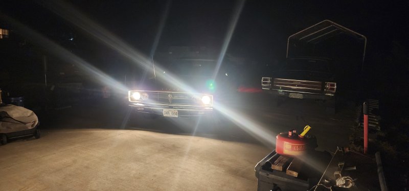

I'm taking my 67 Coronet out for a cruise this afternoon will be returning well after dark. My garage door is white, so I'll try and take a picture for you.

So there is a slight down hill slope going into my garage. But you can see there is a a cut off line in the light I would say about the same
as the original lights. Also note these are the classic white style.
