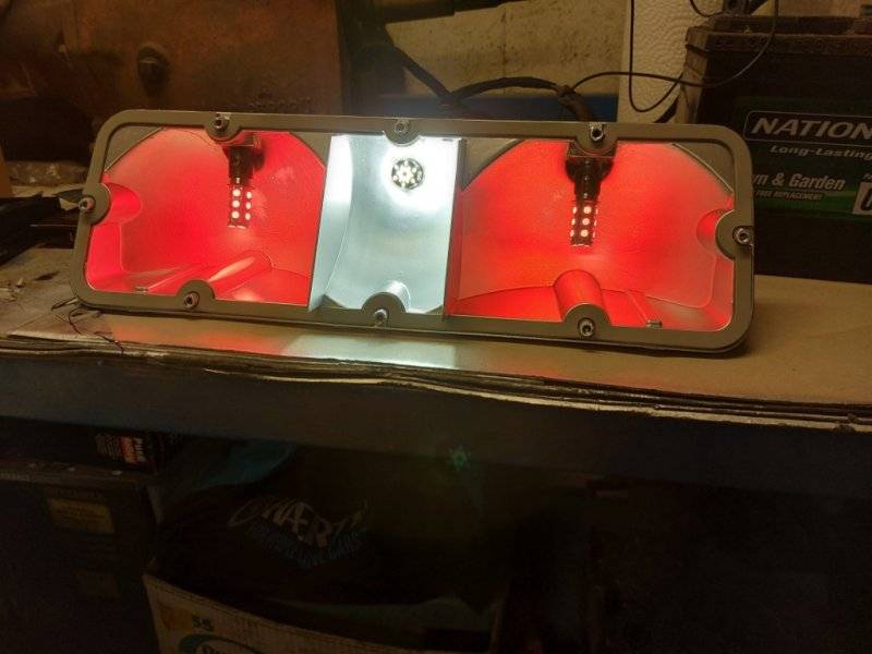

Last night he posted at FABO about how simply painting the insides of the taillight housings a FLAT white allows for great improvements in brightness even for standard incandescent bulbs.
