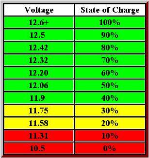

11 volts is low. Also if you changed something with the neutral safety switch the starter relay won't energize. Usually a brown wire from the relay. It grounds the coil.
Should have at least 12.5. _ 13.1 volts to start with.

1. Not enough charge (although the starter should click at 11V)
