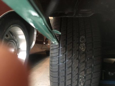

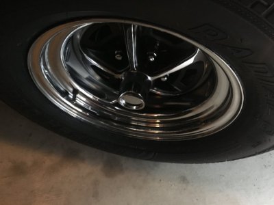

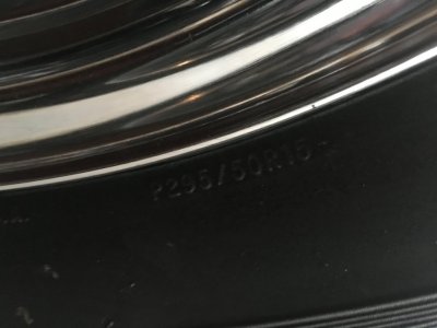

I've got 295/50/15s on 15x8 magnum 500 steel wheels on the back of my 66 charger 5 inch back spacing

I'll take a pic tomorrow. I'm recovering from some medical work I had done. I don't remember the brand tires to be honest but I'll snap some pics in the morning when I get back on my feet.

Coopers

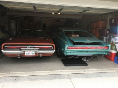

If ya want I'll stuff my 295/50/15s under the back of the 66 coronet i have here but I don't think I need to cuz guys like yy1 and the other dude I'm pretty sure have tried it sure they've owned a few. I didn't realize there was a difference cuz hell a 66 b body Dodge seemed like it would be a 66 b body Dodge to me, but that ain't the case. I know they won't fit under a 67 gtx for sure so probably same as a coronet.
