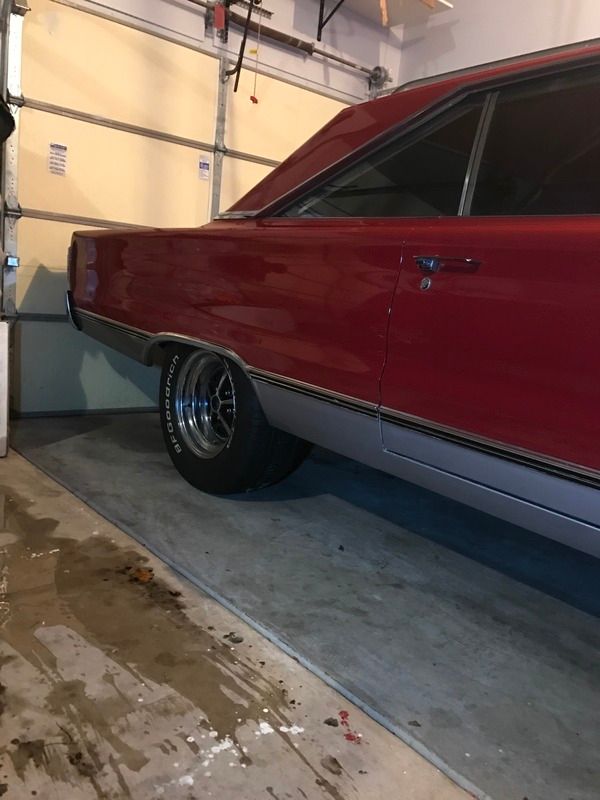

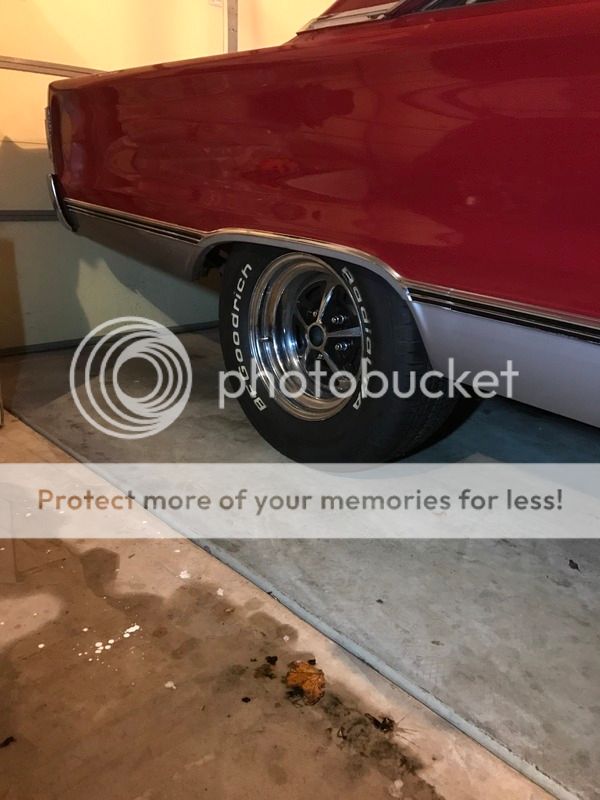

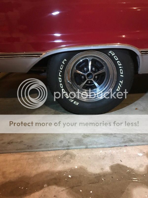

If I go this route, I'm going to get a set of 17x8's custom made with a 5" backspace so I can run 275/50-17's with enough clearance. The wider section width of the 275 setup will "fit" with 4.5" backspace but it's too close for my taste and will probably rub in turns. If that cause too much gap between the tire and the wheel lip I'll add 1/4" spacers to close it up a bit. You can always add spacers later to move a wheel back out, but you can't change the backspace once the wheel is made.
I didn't need to do anything to the springs, but I had to get the car pretty high due to the tire height and tucking it under the lip. I guess what I'm gonna have to do is throw my alumimun jack in the truck and have with with me in case of a flat. Small price to pay to get the wheel/tire size I want.
Very close indeed. While this setup "fits", I was more test fitting to see how much pace I had in the back to get a custom set of wheels built. After seeing what I have to work with, I'll probably order a set of 15x8 with 5" of backspace. If things to get too tight in back I'll a tiny spacer to move it out.
