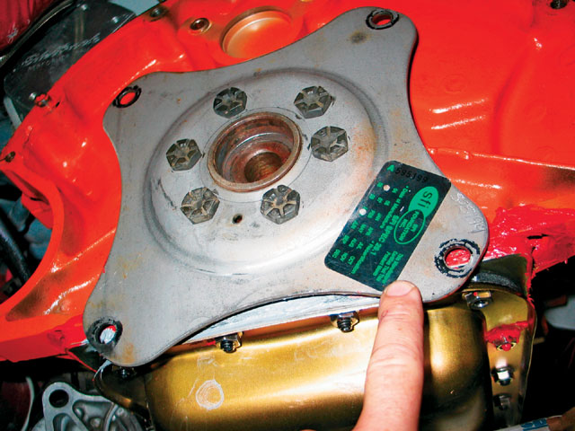

Looking for one to fit right now. Maybe I'm getting confused. I'm talking about the plate that Prop showed above.
Manual calls it a "Drive plate"
You are right on track. That "Drive plate" the manual is talking about, is a Flexplate.

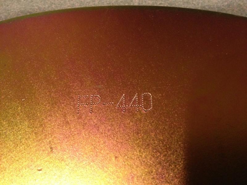

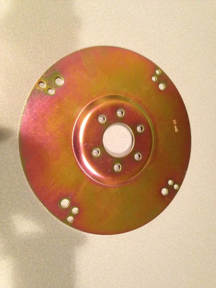

Here is a flex plate I'm going to use behind my 440, which has a forged steel crank and is internally balanced. I purchased mine through 440 source. They have 2 different types available. One is SFI approved at $48.95, the other one I have is not SFI approved and cost $38.95
Here is the link.
http://store.440source.com/SFI-APPROVED-Solid-Flexplate-6-bolt-Neutral-balance/productinfo/200-1084/
They may be available through Jegs and Summit as mentioned above. Hope this helps.
It is drilled out for various bolt patterns for the torque converter.
http://store.440source.com/Solid-Flexplate-6-bolt-Neutral-balance-New/productinfo/200-1040/
This link is for the non SFI approved one that sells for $38.95
