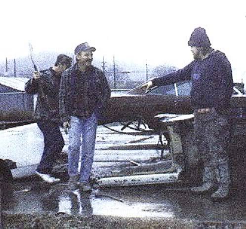

This was insanity... my cousin was junking, and to get the cars on his truck, he was using a meat cleaver (industrial) from a local packing company. About 20 minutes and he had the '68 GTX pictured quartered and on his truck. The 70 GTX in the background went later. Not cherry cars, but MAN I wish I had them now, they weren't that bad.
You can see him swinging away in the background.

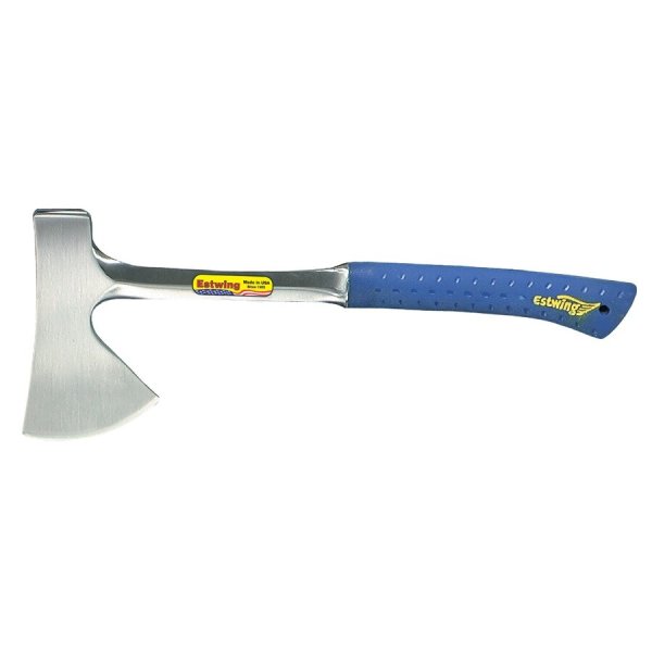

I've done a few... Hammer & chisel? Baa!!! Hammer and Hatchet!!!! Hold the hatchet handle in left hand, blade in contact with steel you intend to cut.. Hammer in right hand, stike te back (Hammer end) of the hatchet... Hatchet typically moves 2-3" with every blow....
My buddy nicknamed me "Capitan Caveman"

The hatchet of choice among car butchers....
The forged head doesn't care about sheet metal.... And the handle absorbs the shock..

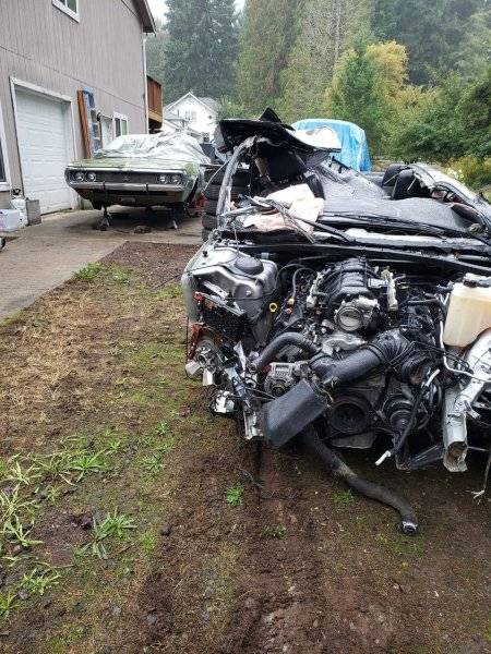

Doing it now on the (very badly) wrecked '16 Challenger I picked up for the drivetrain to use in my Coronet. I think I'm going to end up breaking out the plasma torch too, the sawzall is kinda slow. The pile is growing though.
