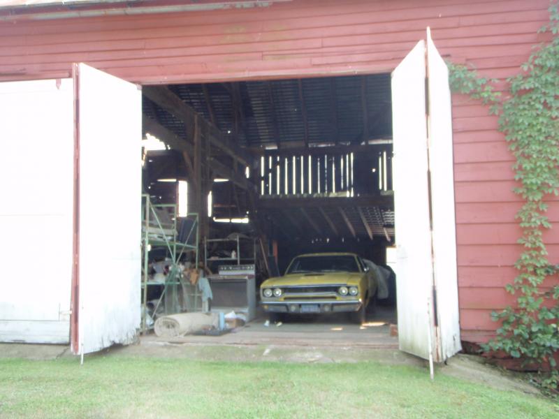

Here is the "Barn Find":

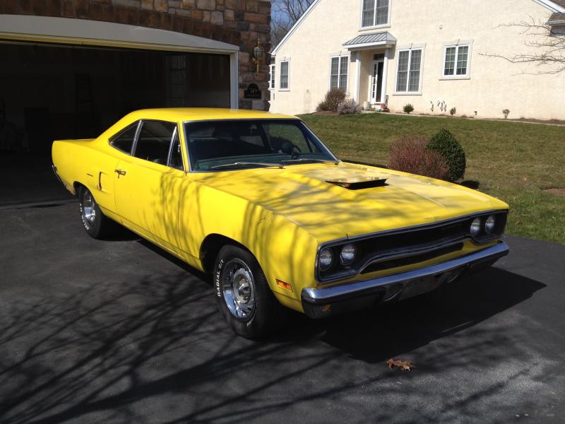

Here is the car after some elbow grease and getting it ready to apply for Antique Plates:

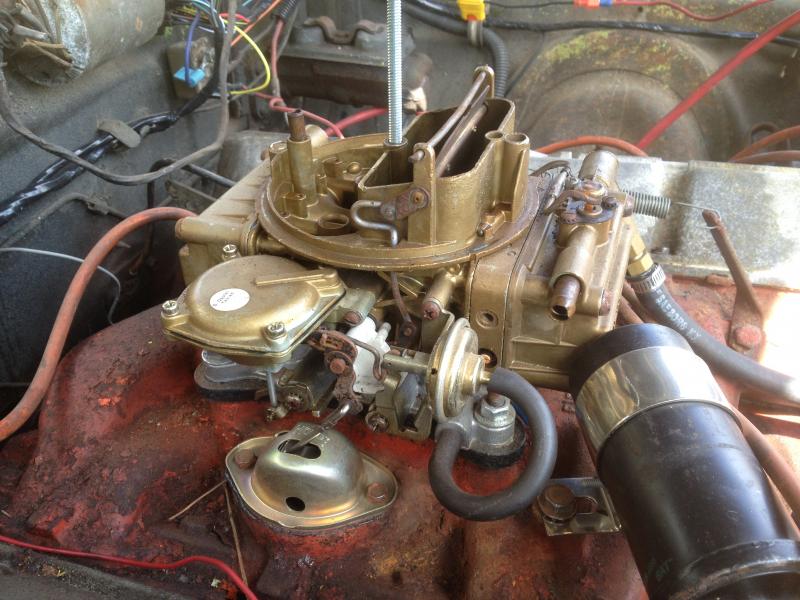

California Choke
California Cars came originally with Holley carbs. This car does not have THE original carb, but at some point a service replacement was added. It is the exact same as the original in looks and function, but has a slightly different number.
Anyway, the car was missing a choke. The choke for a Mopar Holley was different than other cars, and it has a straight "arm". I found one and installed it. This was a nice easy fix once I found the proper choke!!!

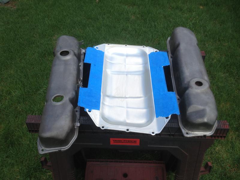

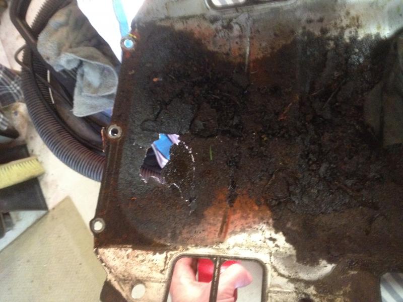

Today's work was to fix my valley pan. It was rusted through in the back. At the same time, I decided to replace my valve covers with correct Mopar valve covers. The covers I have are in bad shape. They were very rusty and have deep pits in them and dents too. For now, I will have to use them and may upgrade them in the future.
Valve covers and valley pan ready for primer:

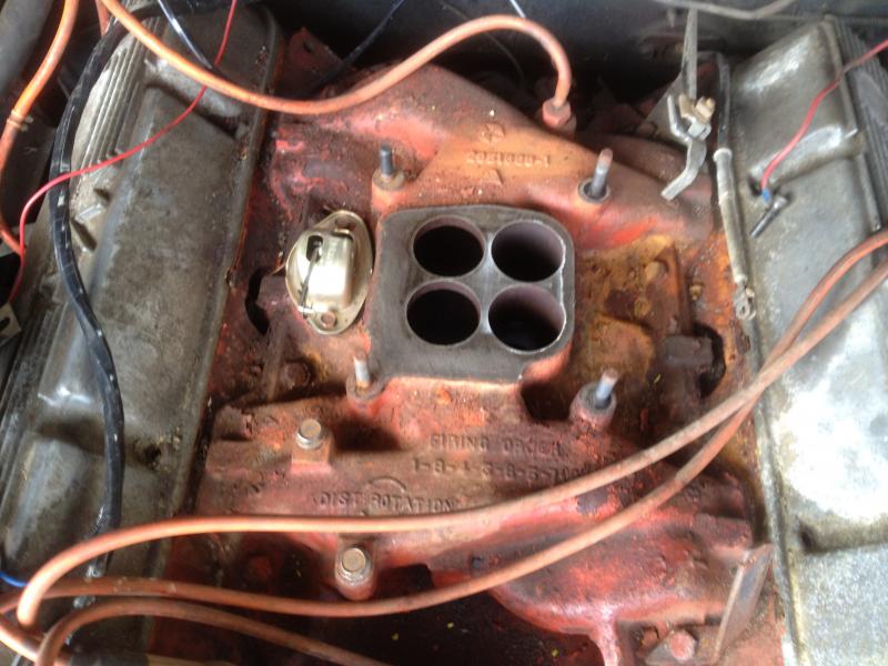

Ready to take off the intake:
Old valley pan - definitely dead!!!

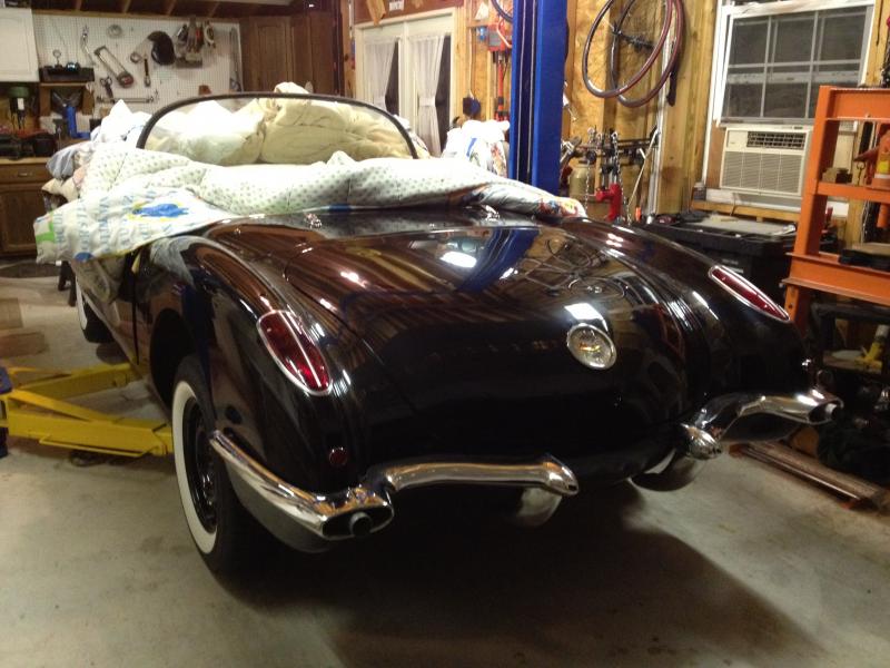

The Vette was a total basket case. It is a dual quad solid lifter car (270 HP) with a 4 speed and 3.70 rear. It has received a frame off restoration with literally every nut and bolt removed and replaced. Currently, all the frame, suspension and bodywork is done. Trans is in it, so now I am waiting for the engine (283 with a 327 crank, so it will displace about 317 CI). I also need to do the windshield and interior. The windshield is a PITA, but I have to dive in to that soon.
Forgive me Mopar guys and gals, here's a quick picture and then we'll move back to the Road Runner...
